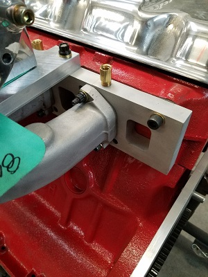

3/4" Intake plate to weld the Clifford intake to.
What is the purpose of the plate?

Rick, the plate is used to positively locate the manifold, and gives us a location to install the bungs for the injectors. The exhaust also locates on the plate.

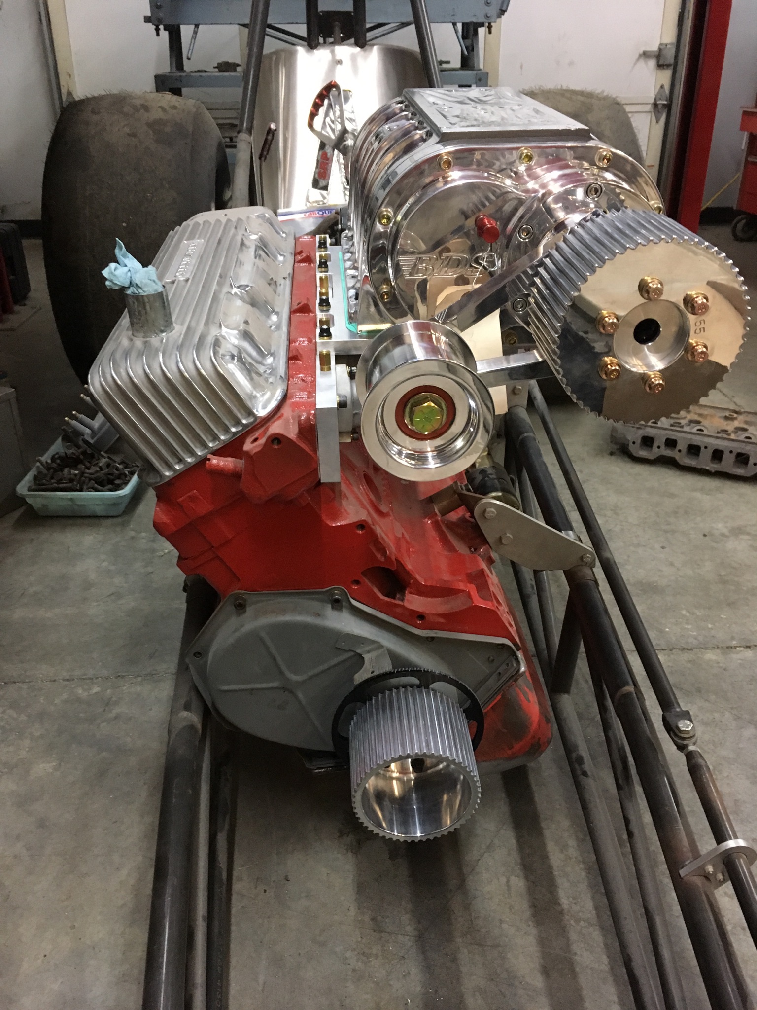

The manifold is completed. There will be a brace to the block once the head pipes are done.

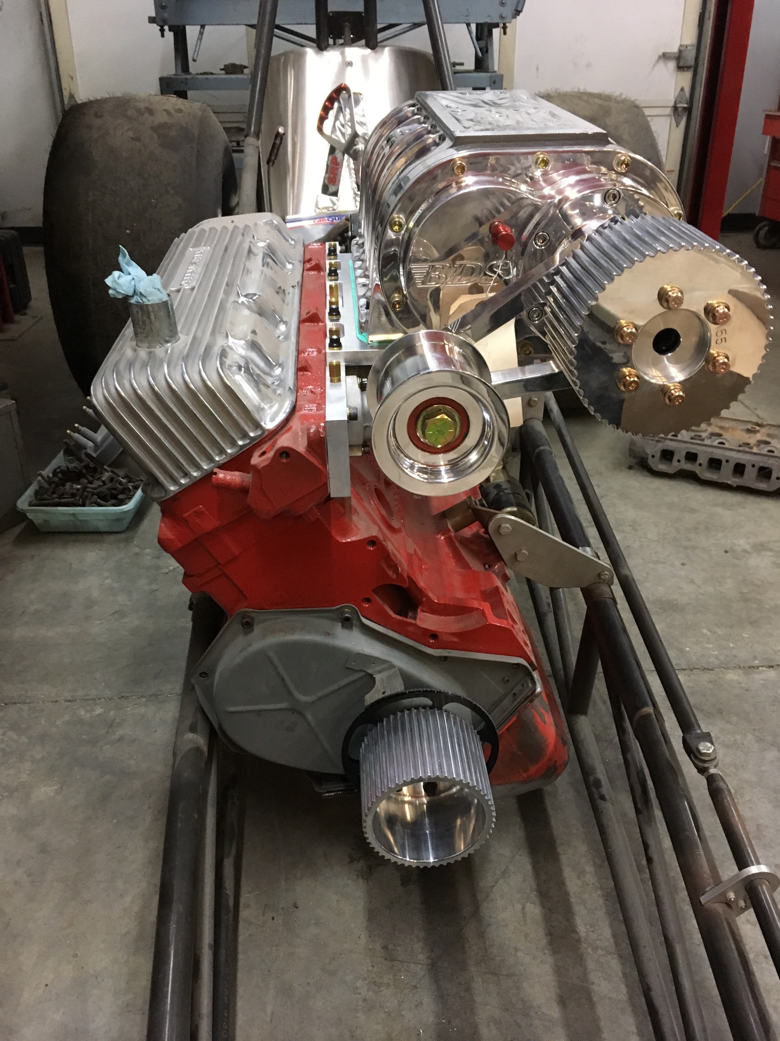

Posts: 1470

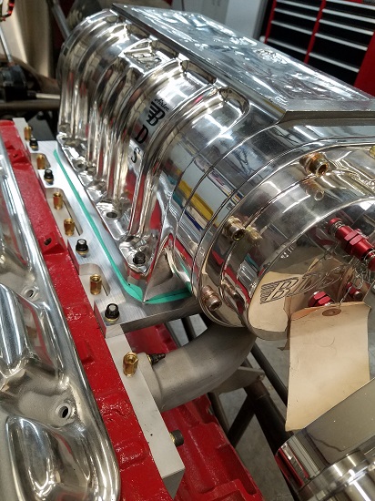

Is that a 6-71 blower that is going on that thing?

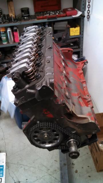

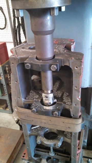

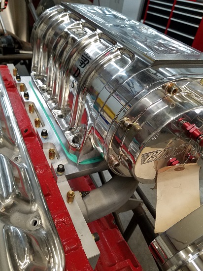

Yes it is. BDS large bore air gap.

It needs a bigger blower...
