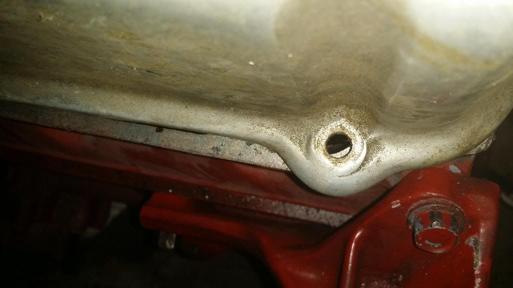

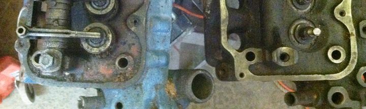

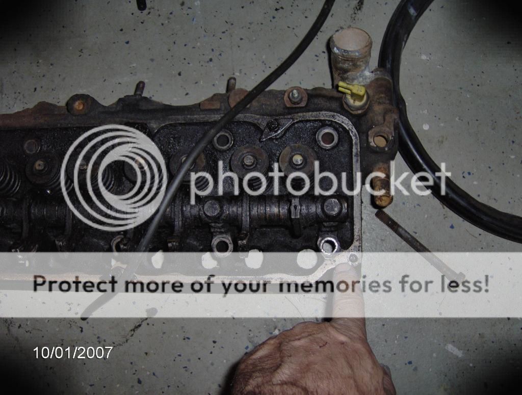

60-80 head profile on the left, 81-87 profile on the right. Look at the bottom left corner of the heads in this picture. Compare the profile of the lip near that head bolt hole.

What's this dog-eared notch? Any pictures for clarification?
I will assume that Reed is meaning this portion of the slant head all the way to the front lower. This is a 1984 head
Did not see the second page. Info already posted
Yep, that's what I am talking about. The ribbed valve covered were from 60-around 67. The only way to use one is to use a pre-1981 head.

Thaks for those pics guys, that clears that up for me, I'm fairly sure I've never noticed that before, but then most of my stuff has always been from the '60s, a 70's slant is new to me. :lol:
Any insight as to why they made that change to that corner?
PostPosted: Thu Feb 20, 2014 5:08 pm
Posts: 13281
None. Absolutely no technical reason for it. My only thought is the fact that the change coincided with the introduction of hydraulic lifters suggests that changing the valve cover was done to give the mechanics used to adjusting valves on the old mechanical lifter slant a easy visual heads up that this slant was different and had the newfangled hydraulic lifters.

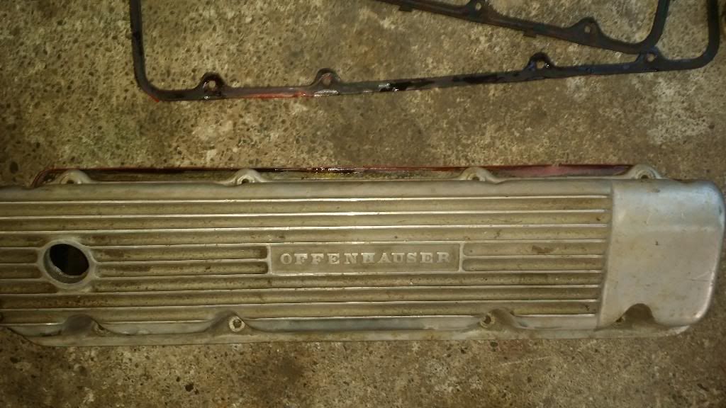

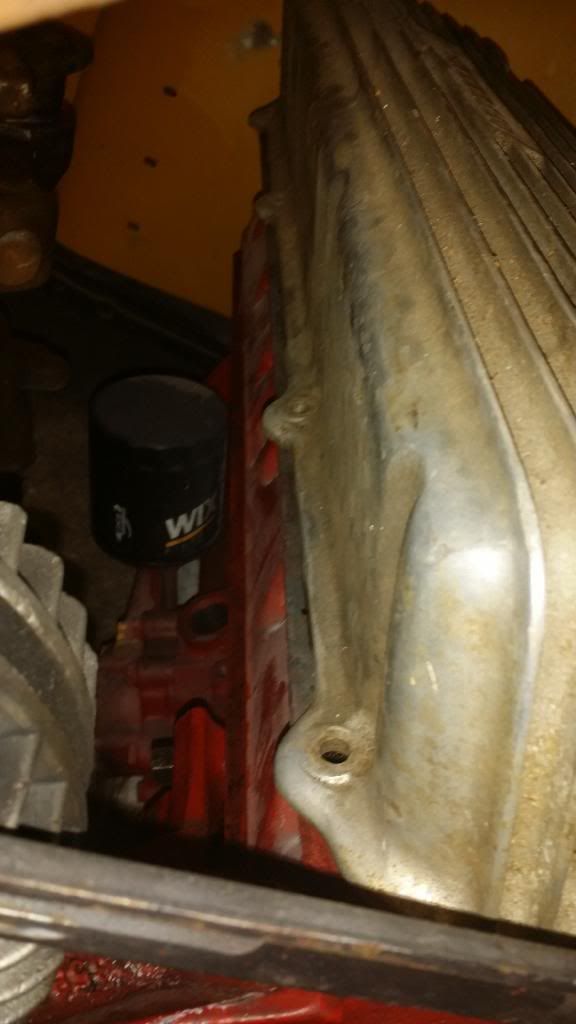

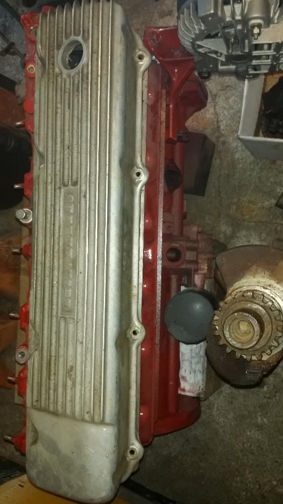

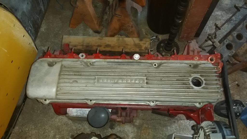

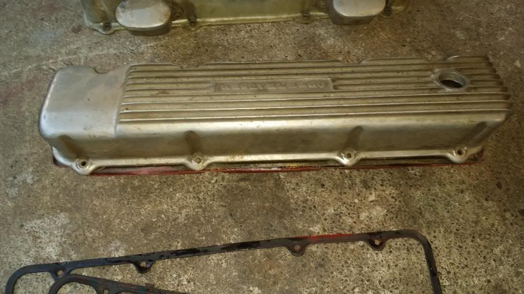

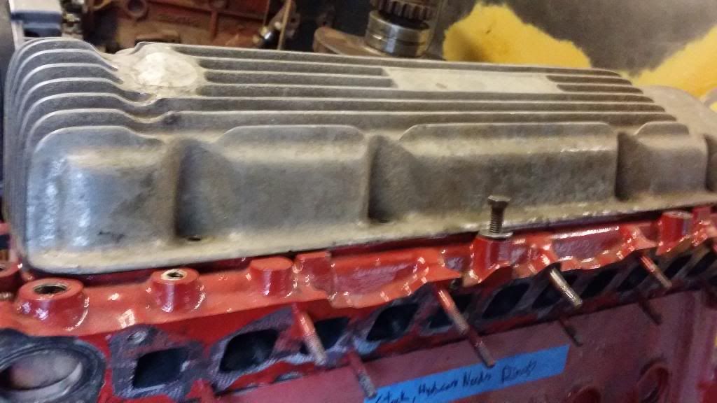

As for an early cover (like an Offy) on a later head the problem is the passenger (sparkplug) side of the head. All of the bolt holes line up perfectly on the driver (intake) side. I still think an adapter/spacer plate could be made fairly easily if someone had access to a CNC.
Early gasket over a later gasket.
Offy cover on a later engine.
Offy cover on top of a later cover.

Mopar Performance did chrome stock style covers for the late heads that were very nice. I have never seen any other type of aftermarket late cover.

The more I think about it and look at the pictures I believe I will just modify an earlier valve cover to fit the later head. I believe this will be a fairly straightforward mod, I can post pict but am lacking the valve cover at this point.
If anyone has one for a reasonable price than I would be interested. Thanks
You will have to split it and widen it about 1/4" and maybe swap the mounting surface from a later cover onto the plug side. A stamped stock cover it could be done pretty easy, a finned cover wouldn't be worth the time or money to cut one up. If you were dead set on an aluminum cover for a late model it would be less work (aluminum welding) and fab time to just make an adapter and then sell them to guys like me who don't have the time to make our own.
