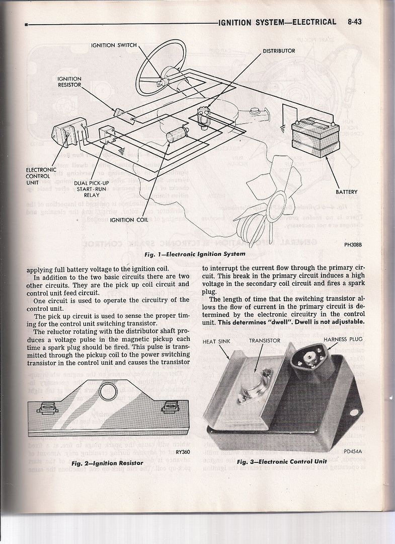

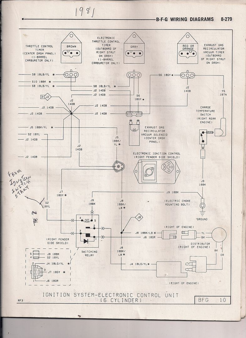

Image Relay switched the pickup coils

No, it's according to the position of the ignition switch. "Start" cuts in the Start pickup and cuts out the Run pickup. "Run" cuts in the Run pickup and cuts out the Start pickup.

Neat, ok so a relay does the change over. The single coil EI system seemed to work fine for many years before. Did something change that made starting harder, requiring different start timing ? Perhaps emissions related.
I'll agree that hotter spark bit doesn't make sense. The pickup itself has nothing to do with how hot the spark is. It just tells the module when to fire.
Thanks for the diagram matv, that made it clear.

PostPosted: Tue Jun 30, 2015 7:37 pm
Posts: 1603
Image[/img]
PostPosted: Tue Jun 30, 2015 8:27 pm
matv91, elsewhere in that service manual it will describe the reason/function of the dual pickups.
