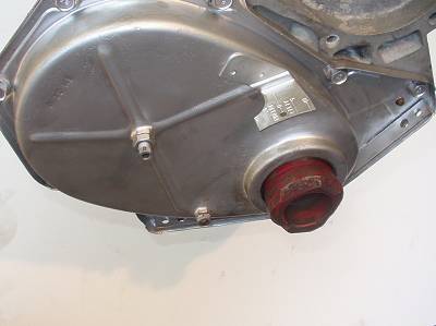

IIRC, the cam stop idea for Slants was originally to try and ward off the dreaded oil pump gear failure.
My good motor has one. It's just a nut brazed to the outside of the timing cover and an adjuster screw from an old rocker arm. Grind the face of the cam bolt smooth and call it a day. :D

That is what I do... braze a nut to the front of the cover and use a rocker arm adjusting "ball screw" with a lock nut.
I have a special "punch" that helps me find the place to drill the hole in the T. cover.

Yes. When efficient engineering reigned, the tapered lobe/convex-face
tappet was designed to do both. Some better than others. My 1st cam was
a crane 260/.440 unit, it had ridiculously wide lobes and solid/sided tappets,
it killed my dist and oil pump gears. I like to drive very hard,and that means
putting the frt. discs to the test w/decent tires.I was experiencing an idle
drop, and that explained it. I replaced it w/a purpleshaft 276/.490 set,and
riveted a plate to the t-cover,then machined a delrin puck to fit over the
cam bolt. I cut a notch in the washer side, then welded a "key" on the
washer,..... it's still in there after 10's of K mi.,and 8yrs. year 'round use.
