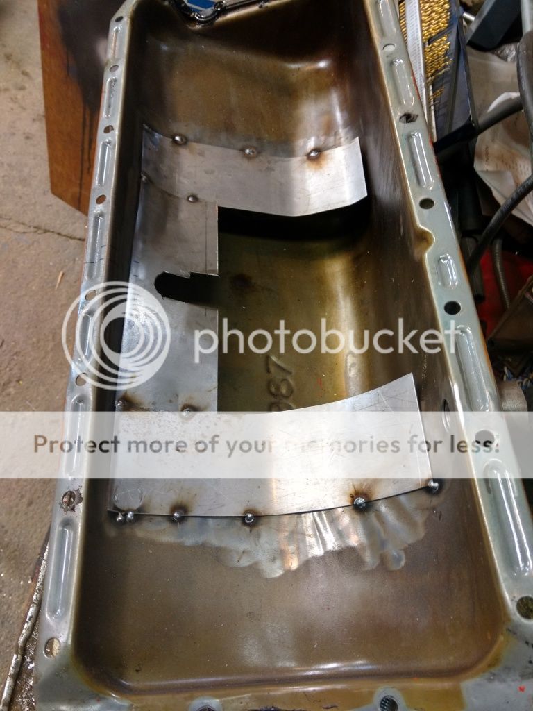

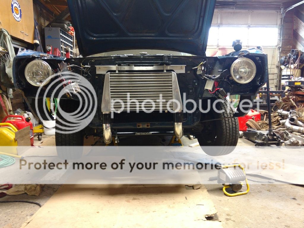

I did get a few things done here this past week.
Got the intercooler mounted up, just needs to be moved down about an 1" from whats in the picture to clean the hood latch.

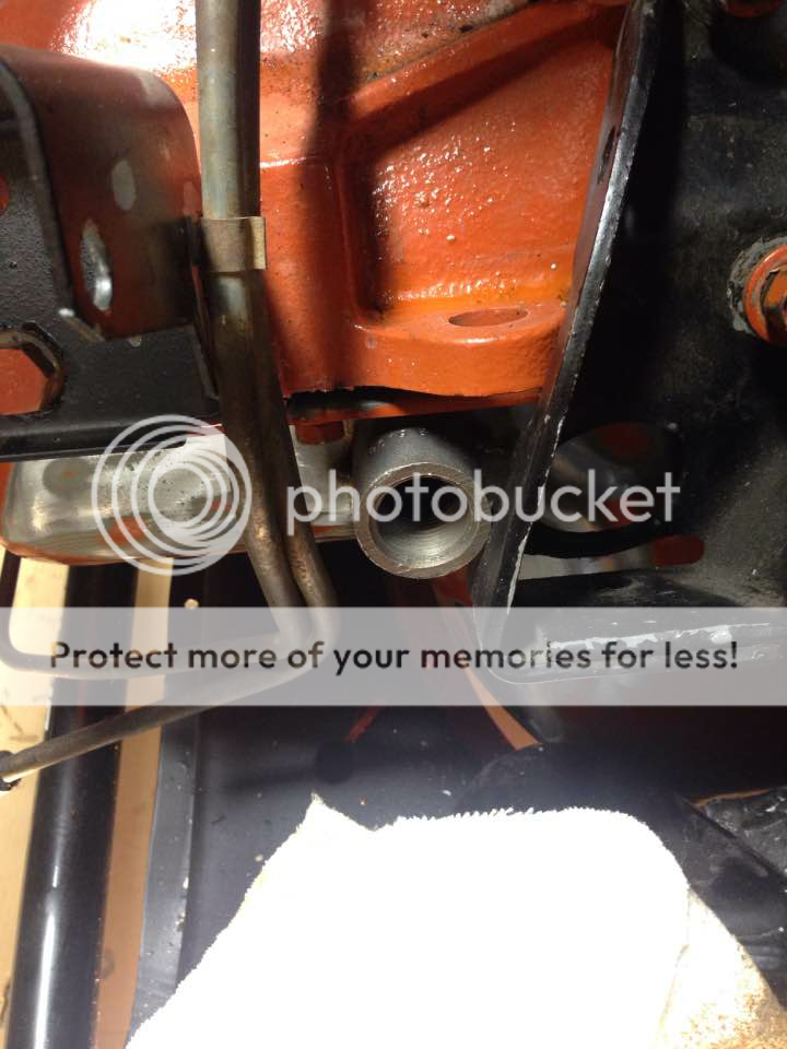

Also got the oil pan removed, which was quite the Job!! Yikes, jacked up on the trans, got the drivers side motor mount off, got all the bolts out, then had to pound on the front of the pan to clear the K-Frame. Then Success!!
Drilled out just over a 1/2" hole, which will just clear the motor mount and the powersteering bracket on the motor. (Left side of hole: PS Right: Motor Mount)
Found a 3/4" cap, drilled hole through it, tack welded it and set oil pan back up to see if it will all work out.
Now since the pan is out. Had to do something about the sump.
Buddy of mine, had some sheet metal laying around, and a sheer, so perfect!
Cut me three pieces, 3"x9", and I bent them to fit.
One for the front, rear, and passenger side (pass not shown)
I'm hoping this is going to help, I just laid them in place, will tack weld and try fitting to make sure it clears.

Well I got lots done in the last while.

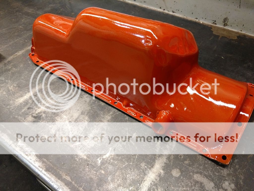

Oil Pan baffles are all welded in, bung is finished, and pan is repainted!
I'm happy the way it all turned out, now just need to install.

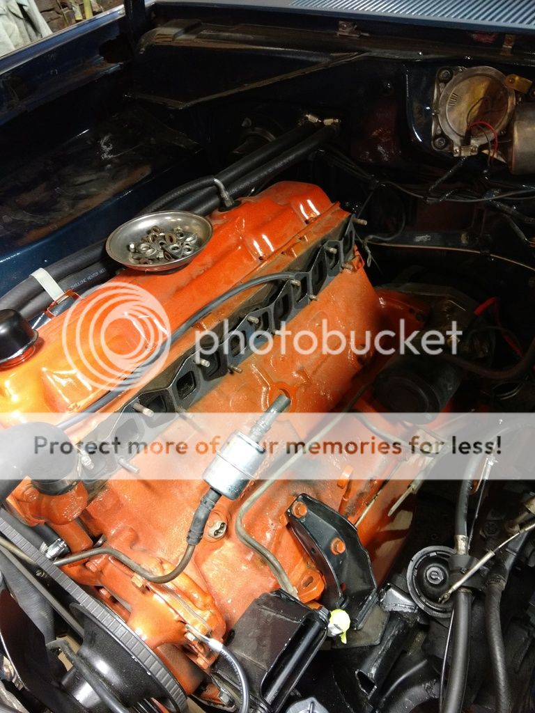

Next was setting up the oil lines and oil cooler, I got the cooler mounted and added in a couple Tee's off the oil pump for the idiot light and a oil pressure gauge.
I had to put an offset from the pump as the tee would had hit the block, its not a straight shot out. So off the end I will run 1/4" steel line, bent at 180* and go straight to the front of the car.
Oil cooler mounted behind the intercooler, just a mock up, need to tighten bolts and run the steel line through the rad support. I got some steel braided hose made up with -6an fittings to match the oil cooler.
And the DEAL of the WEEK... I've been on the look for a 2bbl Holley carb to setup as a blow through. Happen to run across locally... 350cfm Demon, brand new never been used!!! $100
So I got reading again on http://www.hangar18fabrication.com/blowthru.html on what I need to change to make this a blow through.
I guess I didn't really need alot, I picked up a notched float as well as some jet extensions. I removed the choke assembly.
So good to go, other that tweaking when I'm ready to fire up, and play with Jets, PV...

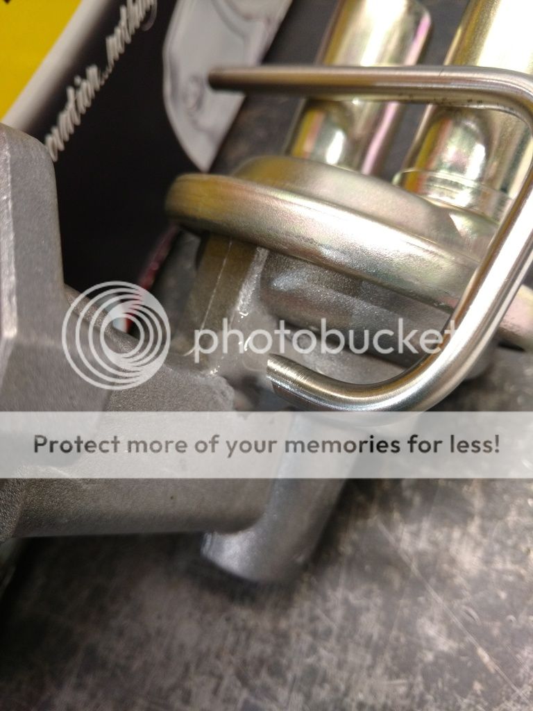

I drilled out the hole on the side to 1/4" as that was the size of tubing I had found. Bent it up, scuffed up the tubing as well as the side of the pump. Mixed up some JB Weld, and coated away.

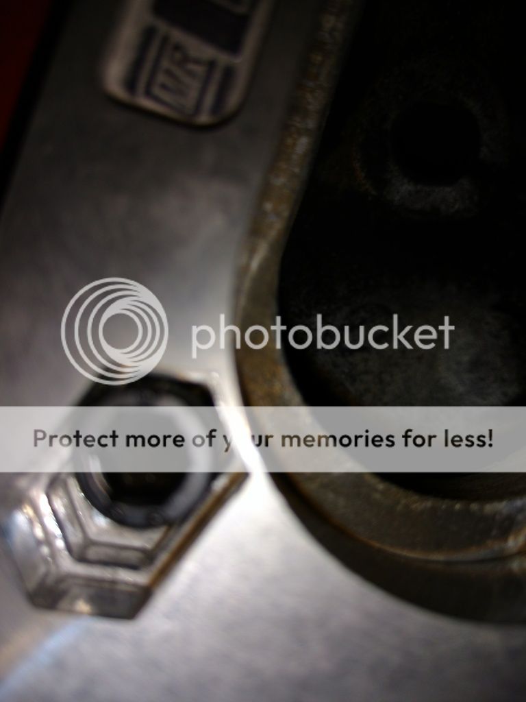

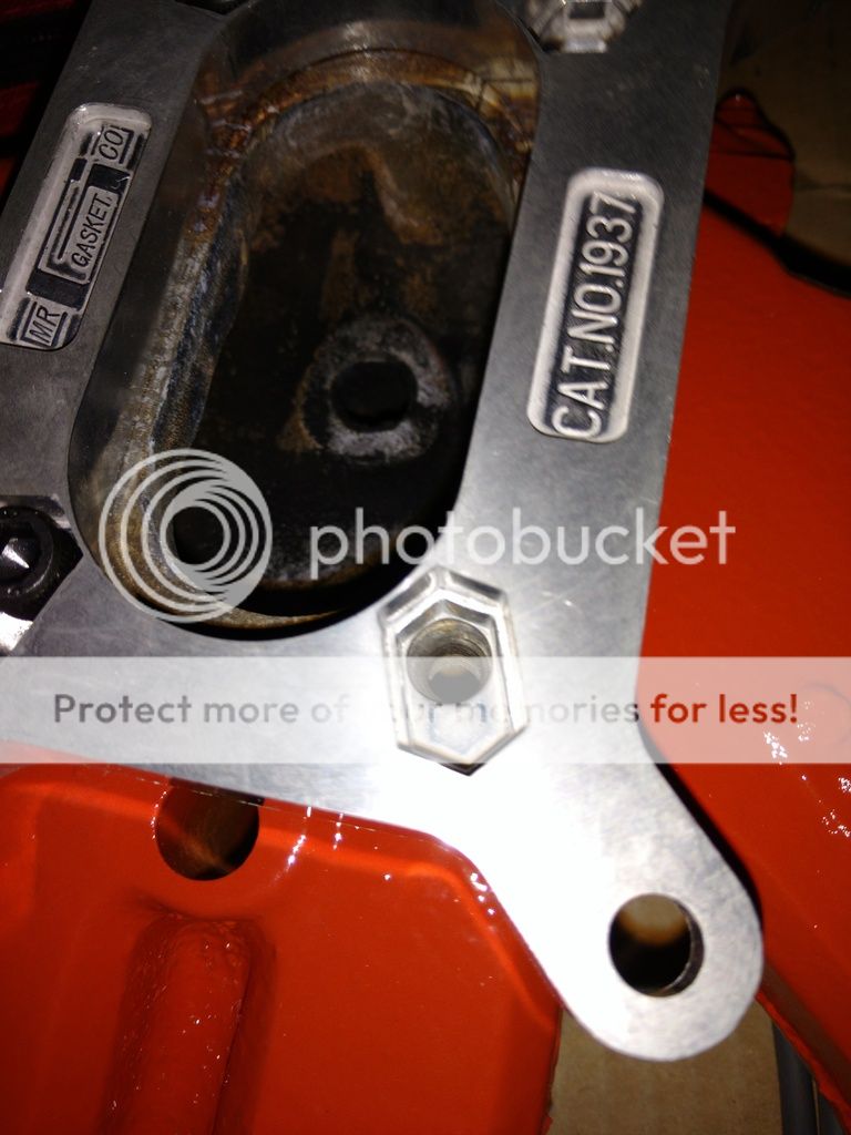

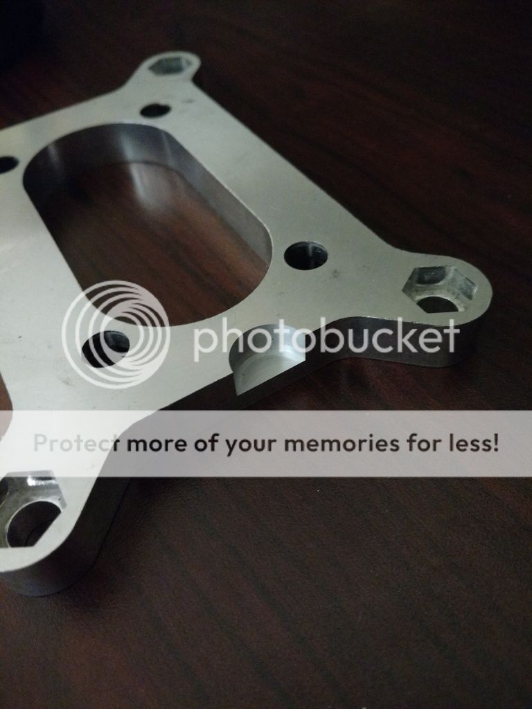

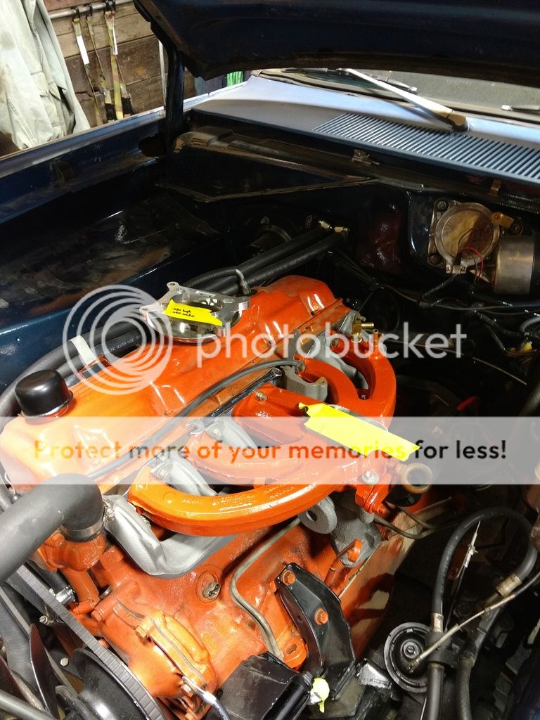

So I was getting ready to install my 2bbl adaptor plate from Mr.Gasket and noticed a few things odd.
The allen bolts they give you are useless for bolting the adaptor to the manifold. there is almost no shoulder on them to grip the adaptor.
Where the bolts go through the plate, why is there a hollowed out space which limits the ability of the bolt to hold it in place comfortably?
Hope the pics show what I'm trying to say.
So I ended up finding some different allen bolts that had a much bigger shoulder, and sanded the edge down to make a tight fit.
Got some more IC piping done, I had bought a 2.5" kit that had two of everything; 180*, 90* 45* and straight pipe.
So the 180's were to wide and would hit the k-frame, so I got a guy to cut them 2" narrower and re welded them. Turned out not to bad.
I cut the one end shorter that fits to the IC and now just need to make rolled edge to hold the clamp on. Plan on using the old' Washer/Vise Grip/2.5" exhaust end clamp trick!
I got the intake removed and replaced with the 2bbl super six.
What a pain to get the bottom nuts out and back on. That took the most time!
When I went to place the adaptor plate on, I found out it would not clear the bolt/nut that holds the intake and exhaust together.
So I got a buddy to mill out the spot it was hitting.
Turned out awesome!!
Just need to fit it on and get the carb mounted, get the turbo exhaust mounted again, do some more IC pipe fitting, add oil feed/return line to the turbo and mount the fuel pump!
