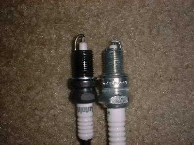

i'm changing plugs in my 1964 belevedere because the oring are leaking. According to this thread I have ordered the Zfr5n but there are a lot longer than the trl79 (motomaster) that was in place.
Go ahead and use the ZFR5N plugs.
Also the plugs still has the washer. And the was running great.
Remove the metal ring washers from the new spark plugs.
Thank you Dan
I was a bit affraid because there's like 3/8" difference.

Like this:
is fine...
The extended tip plugs didn't exist when the slant was developed.

is fine...
For a stock to mild build 198 or 225 slant six... it gets a bit tight and measuring is needed if you are starting into a 10:1= compression ratio build...
