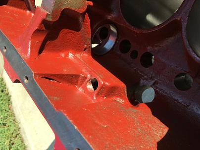

progress on the motor block
inside: Gyptal 1201 Red Enamel
outside: IH Engine Red
concerning the casting defect shown in the second photo......
Chrysler had a grey iron foundry in Indy through the early 2000's.
Called the Tibbs Avenue Foundry, had previously been The American Foundry.
Its all gone now.....
They implemented a molding upgrade in the mid 80's called Impact Molding.
One disadvantage of Impact molding was it produced very hard molds. A hard mold will have
lamination that will break free and float when shocked by the hot metal inflow.
I believe the photo is a mold scab. If the mold scab had floated to a bearing bridge or head face area it would have scrapped this particular casting. As it is, it resides in a non critical stress area, does not leak,,,for me is an interesting curosity.
