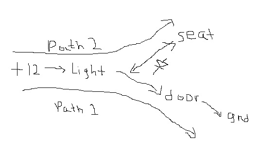

The dome light (dimly lit) is on when the door ajar circuit is the only possible source of power. The seat's main power sources, one 10 amp circuit (fuse) and two 20 amp circuits (fused/breaker) are in a switched fuse box (only powered when on ACC or RUN via a relay). When the key is on ACC or RUN the dome light issue resolves.
So, if I understand what your saying, the diode would be in each of the door ajar circuit wires. You're suggesting that current can flow back into the dome light? Wouldn't a diode in the dome light (downstream) wire work? Perhaps I don't understand what you're suggesting.

Crude sketch, but illustrates the point. With the diode in place as drawn, path 2 is stopped. If the module has a separate lead to each door switch, then yes you'd need a diode in each.

Thank you, Pierre.
Your explanation and diagram make sense. If I get that far, I'm going to ask about the best diode choice. I had a circuits class back in college, but that was in 1984, and it was once a week from 7pm-10pm, so I was tired a lot. I remember that diodes only let current flow one way but that's about it. Essentially, it would be a diode that will handle a 12v circuit and it needs to be installed so current can only flow into the module.

I don't know how the module functions internally so I can't 100% answer what the outcome of switched vs un-switched leads would do. You are quite correct though, you need to get it wired as intended before evaluating function. Who knows what it's doing inside. Unless you have internal module schematics....
Disconnect these leads and run some temporary jumpers directly to the battery to figure it out so you don't have to run wires and make it pretty unless necessary.
The diode, if necessary, doesn't need to be anything fancy. Any labeled silicon general purpose will be fine. You just have to watch out for the current rating. We don't know the exact function of the wire so we can only guess at the current. What gauge is the oem wire in question? You can parallel a bunch for safety margin. You are correct with the one way valve - however it is at the cost of dropping voltage, typically 0.4-0.7 volts.

Brian I'm not sure what you mean by "ahead of the switch". The wires start at the module. The module has it's own ground wire. By this nature since we don't know what happens in the box exactly then the wires have the possibility to be at ground in some fashion.
Also, remember it doesn't have to necessarily be at ground. Say the module has parts of it that run on 5v, and 5v is present on the wire (this is precisely why I asked you to measure .....). You now have 12v on one end of the led and 5v on the other - there will still be current flow. Current will flow from high to low, even if low isn't zero (ground).
