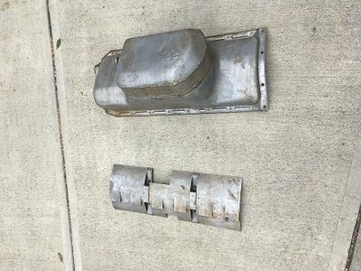

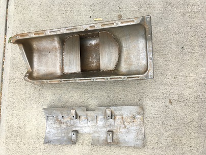

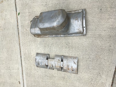

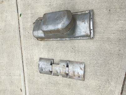

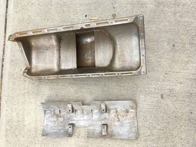

the photos are after soaking for 8 days,,
the molasses mix did a fine job, I am pleased
after I removed the parts I dumped the molasses mix across the back yard grass, we'll see what happens there.
Note: I let the oil pan and tray air dry without rinsing them off while I disposed of the solution,
it adhered rather well to the bare metal, scrubbed it off with a nylon pad and warm water, if you try this, rinse and dry immediately upon removal.

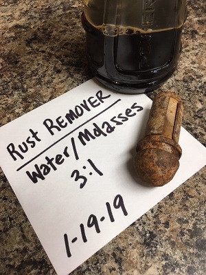

After reading this back when the thread was current, I knew I had to give it a try.
Not having any immediate car-related rust removal needs I decided to try it on a discarded trencher tooth I picked up at work.
As you can see I began this experiment on Jan 19 with a dilution ratio of 3:1
I used molasses we had on hand in the kitchen (not the Ag grade molasses) and mixed it in an empty Powerade bottle since I was working with a small part.

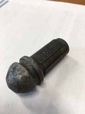

Two weeks later it looked like this:

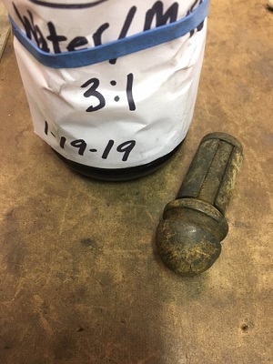

I put it back in the solution and kind of forgot about it. Last night I was putting away some recently purchased supplies when I ran across the Powerade bottle.
Opening the lid, there was a noticeable pressure built up inside. I guess due to whatever reaction was taking place. A quick rinse and towel dry and the piece looks fantastic.
I cant wait to find an actual de-rusting project to try this on.
