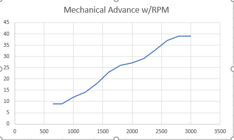

Josh,
Attached to this message is your timing curve mapped. It might provide some enlightening information for your questions.
~THOR~
File comment: Timing Curve mapped

THOR-
Thanks for the Awesome graph!
The timing mark indeed has slipped. Before I started this venture I. Checked it and it was off by two degrees. I used as small long screwdriver as an indicator on where the top of the piston was on the compression stroke and worked the crankshaft in a clockwise and counterclockwise direction until I was sure I was at very TDC.
The governor that i have is a 15L. I believe l, and like you said the timing light doesn’t lie, that the number stamped on the governor is in distributor degrees. So to get crankshaft degrees i would double it, right?
Also I just got done welding the governor slot and putting the distributor on the motor when I saw your reply LOL its no big deal for me to file the weld down if need be. It actually needs more slight filing as im getting 11* total mechanical (24* with 15* initial) at about 2100rpm. What can I say?? I got excited with the spring kit from BigSlant6Fan :mrgreen:
The scamp is not a daily driver and at the moment the plates are expired so im not in a huge hurry to get it on the road. Im actually waiting for cooler weather to replace some rotting spots in the trunk and floor. Its to hot for me to do extensive welding.
This may be a dumb question THOR but, if the slots werent welded and I put lighter springs in it I would still see the full 30* advance plus my initial just sooner in the rpm range correct? According to wjajr 30-31* of inital+Mechanical advance is ideal. I know everyones motor likes something a little different but does that 30-31degrees hold true for most slant builds? Mine is mildy modified but pretty much stock.
Also im kind of starting to worry, I still havent heard any pinging throughout any of my testing/datalogging. In fact I dont think I’ve ever heard it before. I do have a fuel pump that knocks at random, and I made triple sure it is the pump with a redneck stephoscope.
Again thank you for plotting the graph for me.
-Josh

Glad I could help.
30-31 degrees "all-in" is perfect for a stockish slant. If you put lighter springs in it, you get more mechanical advance sooner. If you are "all-in" by about 2500, that's about right.
The cam turns half the speed of the crank, so it's a 2:1 ratio. 15 on the cam is 30 on the crank.
This isnt a dig, but frankly, unless you have a degree wheel and positive piston stop (which bolts to the block with the head off) I find it hard to believe you know exactly how many degrees the timing mark is off. I'm not saying you are incorrect, I'm just saying it's very difficult to nail down exactly how far off it is without a pretty specific process.
As far as pinging goes, the slant came with what I consider very low compression. You need to have a lot of advance, low octane fuel, or get it pretty hot before a stock slant will ping.
~THOR~

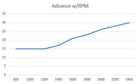

Ok its been a while,
Got the distributor rebuilt and I think I have the curve where I think it should be. Installed the blue and green spring and that brings my total timing all in slightly above 2400. Here is the curve as it is right now.
Initial set at 15* idles at 700
15 @ 800
15 @ 1000
15 @ 1200
17 @ 1400
21 @ 1600
23 @ 1800
26 @ 2000
28 @ 2200
30 @ 2400 (closer to 2450)
THOR- thanks for all the tips and advice I sure appreciate it! Cant wait to see how it acts on the road...
Mitch- thanks for your input. Question, why did you set you advance curve to be all in around 3500?
-Josh
 Post subject: Re: Ideal timing curve?
PostPosted: Fri Sep 28, 2018 2:44 pm
Posts: 1548
Location: Dallas, Oregon
Attached is what your timing curve looks like with your adjustments:
~THOR~
