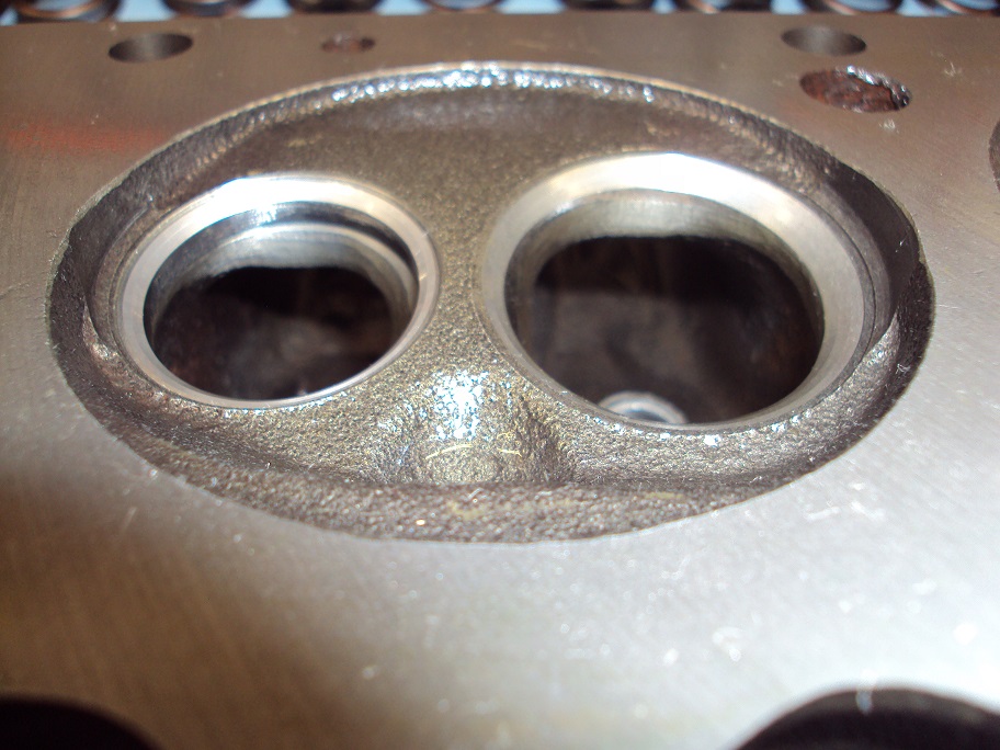

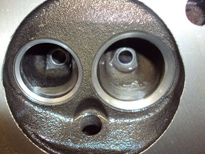

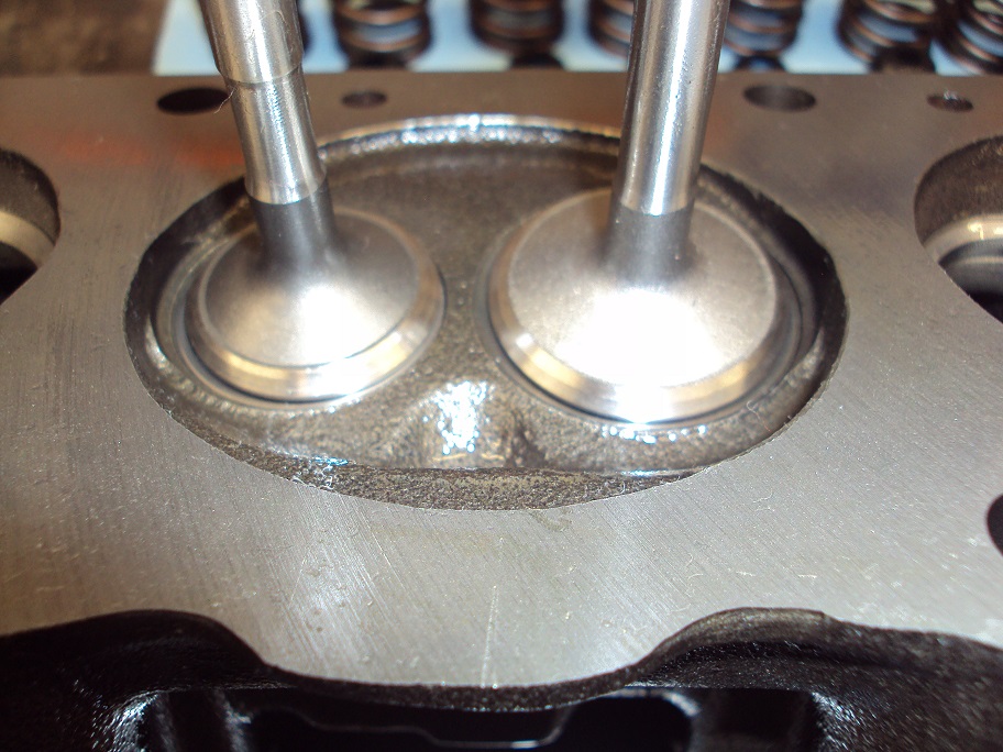

Couldn't resist doing a little bowl blending while things were apart. Valves back cut 25*.

Cool stuff John!

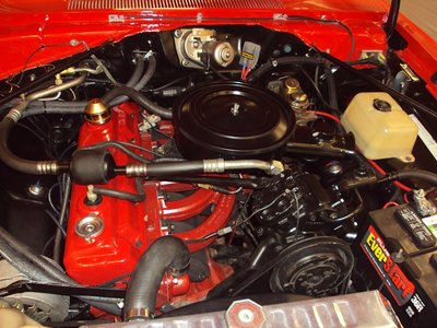

All back together. Runs real good - and on all 6 cylinders. :D I will get a few miles on it before I run a comp. test and check the valve adjustment. Seems to like a lot of lead. Running 10* BTDC ( on a stock electronic dist. ) now and might try a little more. Until I can put it on a dist. machine, I don't know what the stock curve looks like, or how much advance is in it? Running ported vacuum on the vacuum can. Might try manifold vacuum for grins. Again, not sure how much is in it. I can get away with murder up here at 5000 ft above sea level and 7.8:1 CR. :) I can now probably put the hurts to my Buddies Prius. :mrgreen:
