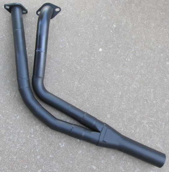

I think correcting the flange mill would be easy. However I have no experience casting steel. But with the angle mill they aren't going to fit many applications, if any. I hope if they do reproduce them, I hope they produce an exhaust pipe system. I don't think the one I built will fit a 225 engine.

Is that the factory collector pipe ?

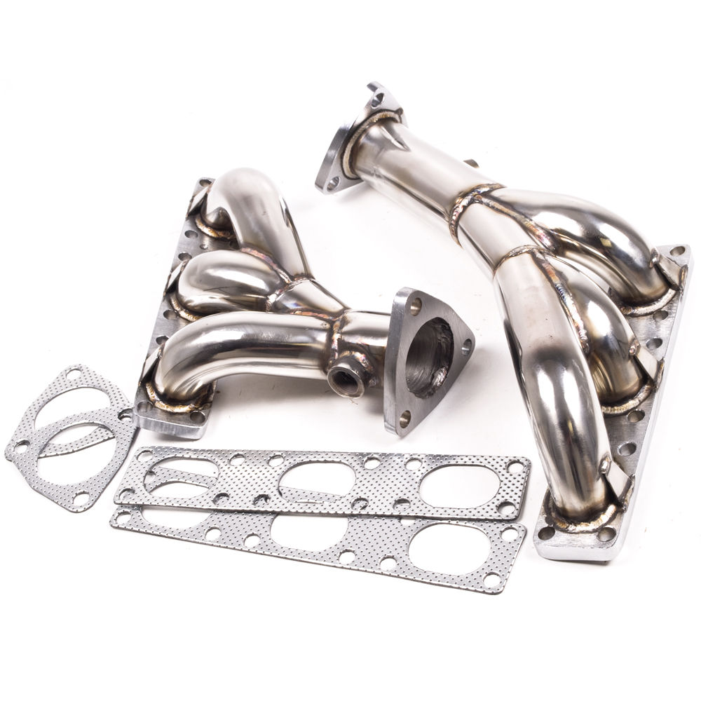

The HyperPak manifolds are cool due to their heritage....but for most people a 'modern' set of pipes would make a lot more sense, and not require any castings.
For the $600+ I see being charged for iron manifolds, it seems a nice set of SS headers could be made. They'd presumably make as much power, or more, and be lighter. I don't mean 'headers' like the ones that are currently sold, but something more like a production manifold/header that you see on a lot of cars. Or even a 'shorty' type header. This is a set for a BMW 6 cyl but the concept is the same.
So....are the iron manifolds being pursued for the 'legacy' factor or?

I don't consider myself qualified to speculate on why others might buy them or at what price. I built a stainless set of headers as well as a stainless turbo manifold and they look great. While I am not a fabrication whiz, the time/fitting/headache factor significant. For myself, the appeal is to have a durable upgrade, less prone to cracking than the stock exhaust manifold. Increased performance and a factory iconic part.
So what factors would make someone want to purchase a set ?
