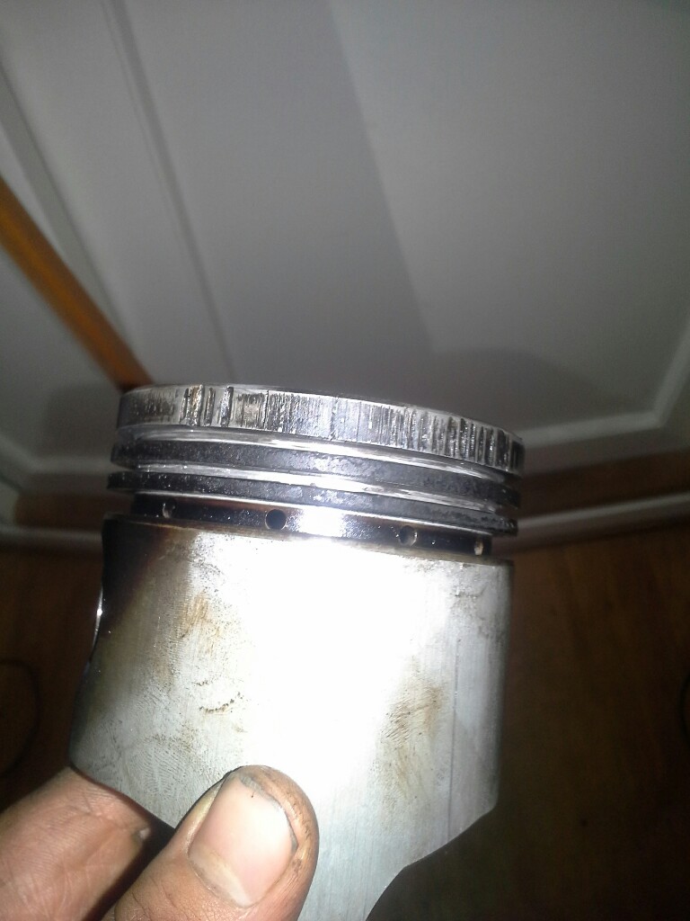

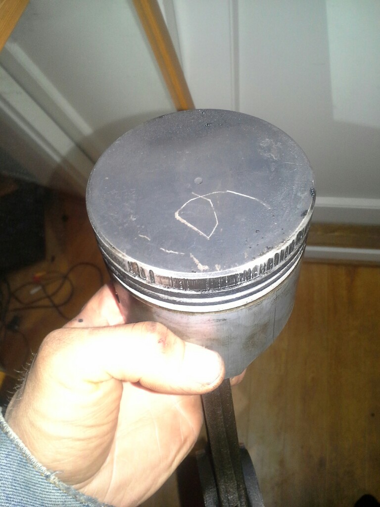

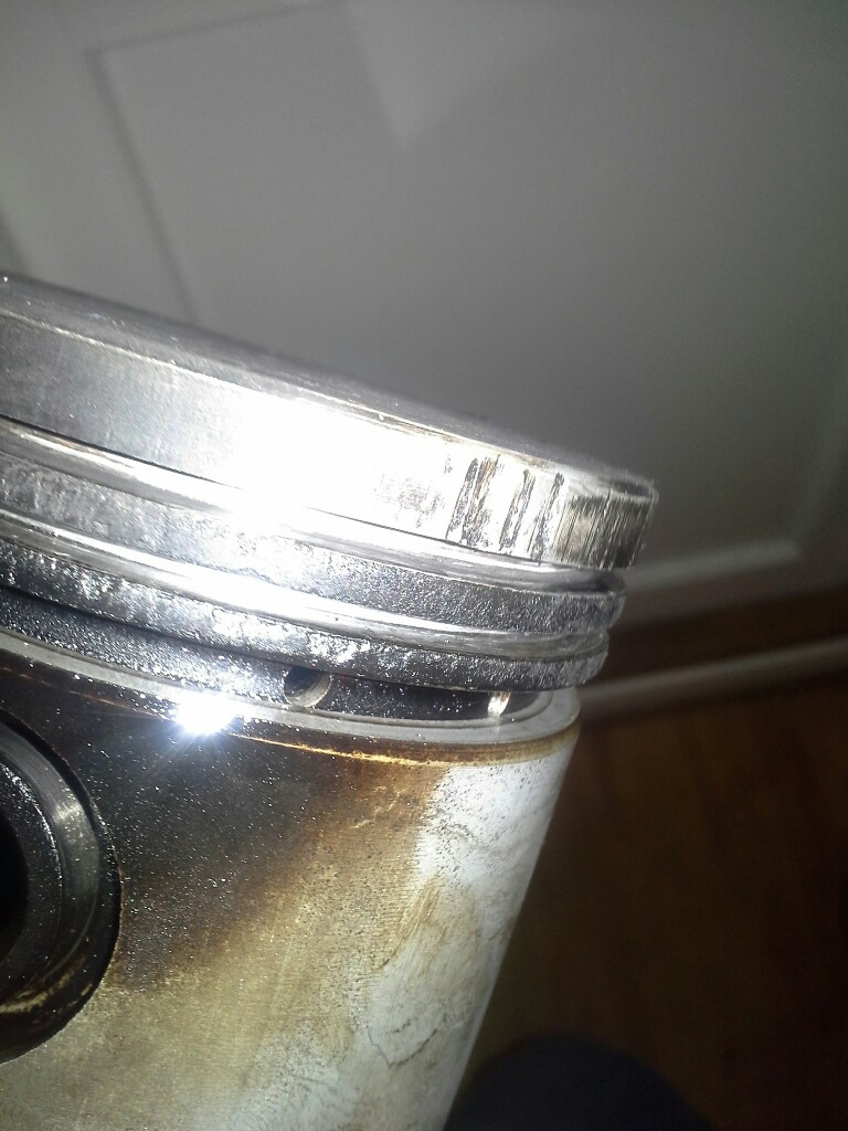

...this whole thing wasn't something I prepared for....
And if the damaged piston comes apart and ruins the block and crank you'll be even less prepared for that.
IMO it's never a good idea to put damaged parts back into an engine.
Of course it's your car and your money and maybe you will be lucky.

Some additional pics of the pisto just for a heck of it. I'll run them in a parts washer on saturday.
