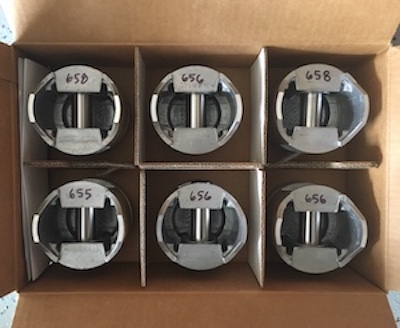

Pistons arrived today!

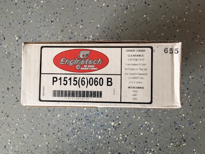

One of the first things I noticed on the box is the weight tolerance is +/- 2 Grams, so I weighed them. Box is stamped 655.
On my electronic scale one weighed 655, two 658 and three are 656. With a range of 655-658, his set is outside the +/- 2 Grams with these weights, right?
Should I attempt to bring the two 658 pistons down to within 2 grams? What would you guys do?
PostPosted: Wed Apr 10, 2019 9:56 pm
Concerning the piston/pin weight,,,
You could remove a bit of weight from the heavy pistons, or
Consider, on an inline six motor, pistons 1 and six move together as do pistons 2 and 5 and pistons 3 and 4.
So install a heavy and light piston on 1 and six.
A heavy and light piston on 2 and 5
And on 3 and 4.
The reciprocating weight will balance out.
To be absolutely correct you should also consider the
the weight on the top half of the rod that is also reciprocating,
but you will be fine.
There are other items much more critical than the piston weights.

I am not sure myself what is acceptable for balance tolerances on different parts and have been wondering this recently. What RPM will be your max? If not above 5500, then I would probably not touch them. Yes, you could grind a little off the heavy ones on the underside and away from thin/critical areas. Stock pistons (and rods) had substantially more variation than this.
Also, those are completely within spec. If you take the average of all 6 and then take a window +2 and -2 g around it, then your pistons will all fall inside that. The absolute number 655 means nothing since you don't need to balance bobwt on an inline 6.
PostPosted: Thu Apr 11, 2019 8:39 am
Balance on a reciprocating engine is another greatly misunderstood topic.
I first always like to admit I don't know much about it. That puts me way ahead of the average hot rodder/professional engine 'builder' who thinks he does. I do know that when I peeked under the hood of my Lexus LS460L - one of the smoothest vehicles you can buy - I'd see some very fancy hi-tech motor mounts. Why would Lexus do that when they have a staff of very smart engineers, a killer R&D lab, and the ability to manufacture just about anything they want?
They do it because they understand you're never gonna 'perfectly balance' a reciprocating anything.
As for piston weight....if you have a digital scale that weighs in grams, the first thing is to find out what its margin of accuracy is. On a 655 gram piston, you might learn that the scale itself is only accurate within a few grams.
Then, you'll find that if you weigh the same piston a bunch of times on the same scale, you'll get a bunch of different readings. Which do you believe? If I were assembling an engine that was gonna spin 10,000RPM with 1-1/2 lbs. pistons, I'd use a statistical approach by weighing each piston 20 times, throwing out the 2 high and 2 low readings, and averaging the rest to come up with a value.
The bottom line? Use the pistons 'as is' and never think about it again. Especially on a 4500RPM Slant Six that has a 75lbs crank...

Thanks, everybody for the replies and reassurances.
GregCon, your take on the question puts in perspective, thank you.
I hadn't considered the range of weights being within spec of the average, I was only looking at the overall range. Since I don't plan on spinning it close 5,000 rpm, I will leave them as they are and match them up as you describe, John.

PostPosted: Thu Apr 11, 2019 6:09 pm
Weigh the piston pins.
Then match a light pin with heavy piston.
