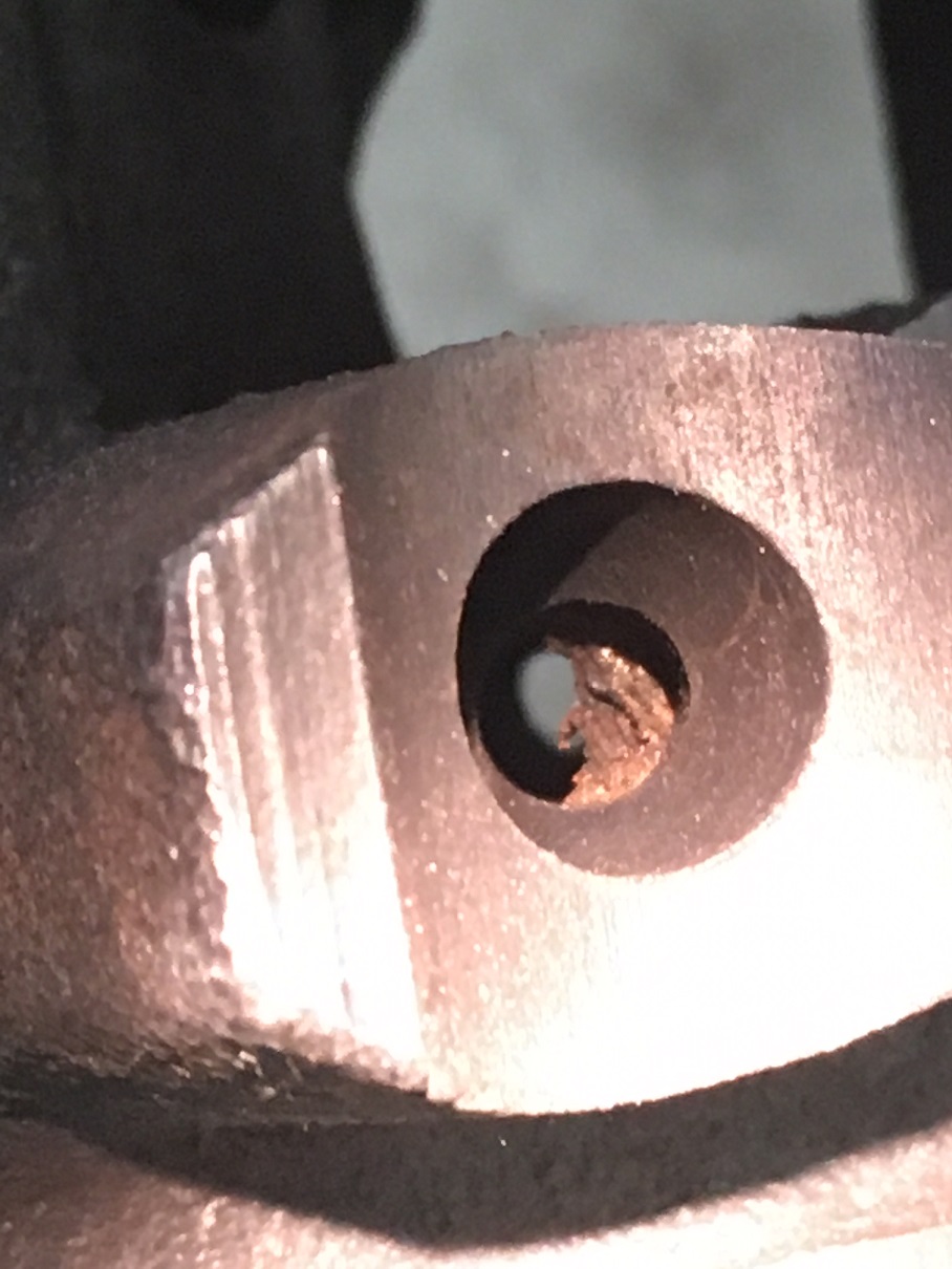

My 225 had 132K miles on it over 50 years. The oil pan was appalling...the oil pickup was completely covered in a crud so hard that I hesitate to call it sludge. The pickup was similarly full and the oil was making its way through a hole about 1/4" diameter.
I found, when I inspected the head, that the rocker shaft oiling hole in the head had never been drilled properly. It looks like the drill didn't break through all the way, and as a result about 60% of the hole was blocked.
Even with all that, the engine was running and driving until the PO ran over a trailer receiver hitch and knocked a hole in the oil pan.
The point being...these engines are very forgiving when it comes to oil, at least in 'normal' service.

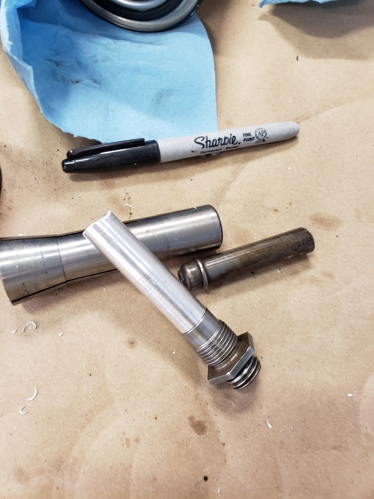

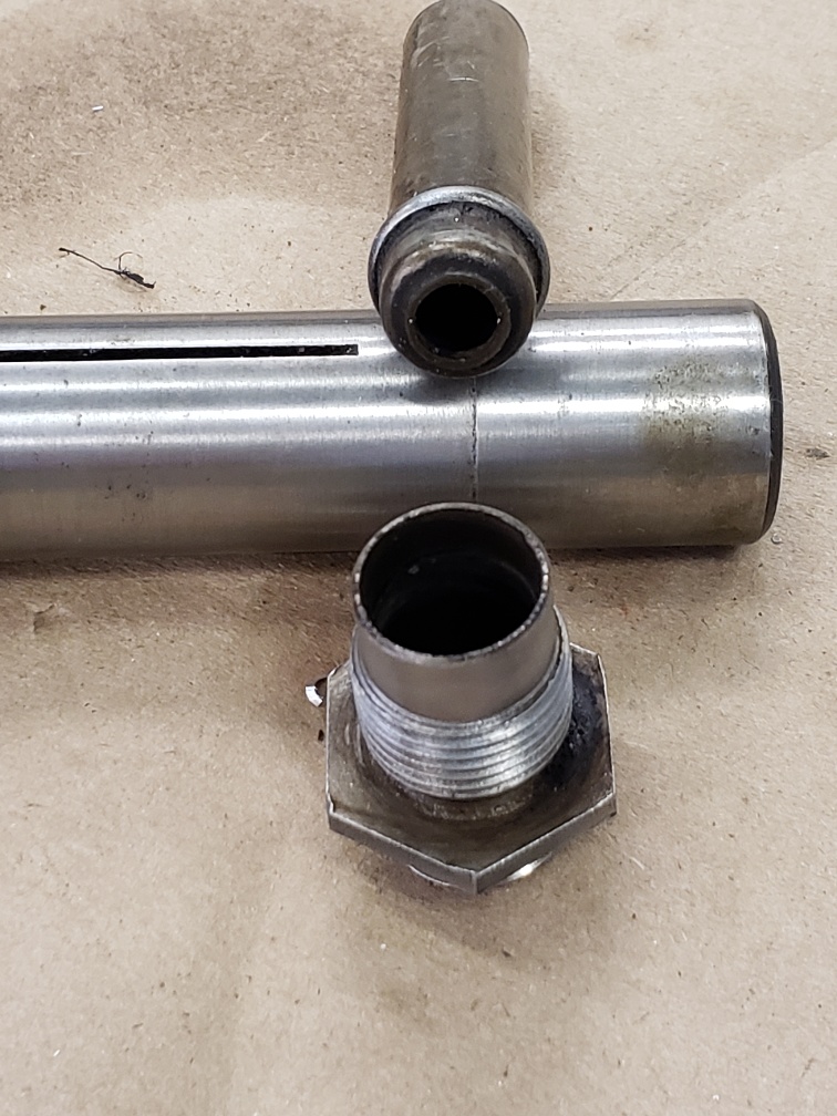

Today I drained the break-in oil out of the 225 for its first oil change. Since the filter was off anyway, I decided to convert from the modern 'no-tube' oil fitting to the old fitting that had the tube to see what difference it would make. Although the oil pressure (with no tube) comes up quickly normally, I did let the car sit for about 3 weeks and I noticed the oil pressure did take about 2 seconds to come up.
I was surprised to see, upon peering down the tube, that the hole is so small. I didn't measure it exactly but a 5/16" rod would not pass through it. What's more....for some reason it's apparent the factory purposely did this as they swaged-down the tube. WTF.... It doesn't make much sense to massage all the oil passages in the block and pump if you neck it down anyway.
So I removed the tube, which came out very easily (?).
I made a new tube out of aluminum since I woulda had to wait a couple days for a piece of SS tube. I made the ID .450" which is much bigger than the factory tube but still a little smaller than the 1/2" modern fitting. I cranked up the engine but didn't drive it yet.
