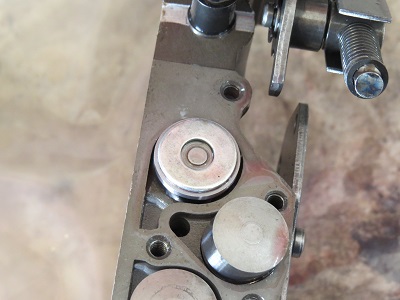

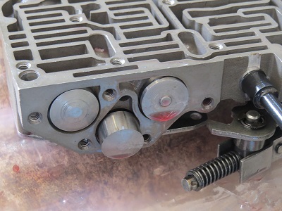

Well, the best thing to do is not give up and learn from the "hard" things we have to do. Finally figured out why I was missing 2nd and 3rd gear.
I did finally give Transgo a call. They had me remove the valve body for the 3rd time and run some more air tests out on the bench. I spoke to an old timer named Larry (88 years old and still working every day!) and he was very very helpful. We spoke 3 different evenings and tested different things in and out of the car. Finally he said let's just disassemble the whole valve body and walk through it piece by piece. After doing so he said you have done everything right! That made me feel a little better. The only thing he could find was that we could not move the 1-2 shift valve using air like he wanted to see. It is a tricky passage to get air into but it just didn't move like he wanted. So after hours of working with me another Tech named Mark said to pull the plate off of the side where the 1-2 governor plug is and put a washer behind that plug and bolt it back together. Shazammm!! The plug moves easily with my shop air. So what happened? If you look the picture the plug on the right has a small nub in the center that holds it away from the cover plate. This is supposed to allow enough space for the fluid to get behind it and shove it over and shift into 2nd gear. For some unknown reason that nub was just a little to short and by simply putting a .04 cent washer behind it, it moved it enough to allow it to do its job! It had no 3rd because the 1-2 shift valve was not moving and that affects the 2-3 shift!
I made myself some notes and will always test out on the bench before assembling another one! :D :D

Great news. It is good to know that the problem was not something that you induced, but something completely out of your control. Now you can get back to racin'. Whoo-hoo!

What was really odd was that it worked fine in the truck for 3 years. It just has to be the pressure and spring differences I guess.
