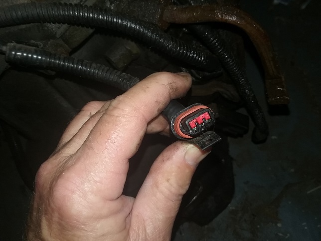

3 pin connector

That's the one you want with the 3 pin connector.

Those pictures are great! Thank you! I found an 89 Dakota with a V6 and an overdrive button on the dash in the same yard, so I am pretty sure it will have an A500. I will use your pictures to confirm before I spend another day on my back pulling a transmission.

OK, here are some pictures. First, for people who are looking for an A500, here are the two areas to look at to make sure yo get an A500 and not a A904.
THe first picture shows the 3 pin plug on the "flat" next to the neutral safety switch. If that plug isn't there, it is a 904.
