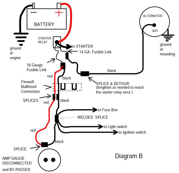

Car Model: 78’ dodge D100 slant six
Is this the correct way to bypass?

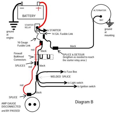

PostPosted: Sat Sep 07, 2019 7:23 pm
Schematically, yes.
This may seem like a dumb question but why do you need to keep the red wire after you change it over? It doesn’t look like it does anything.
 Post subject: Re: Weird problem
PostPosted: Tue Sep 10, 2019 8:24 am
It provides a second path through the bulkhead connector which is usually one of the worst connections in the harness.
