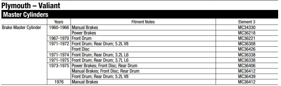

Referring back to this comment:
FYI, the front disc master cylinders have a much larger rear reservoir (for the front circuit).
I am looking at both the 62 (with the 74 Dart disk system) and the 65 (dual drum system) right now. In both cars the master cylinders appear to be identical, which is to say that they are beefy, squarish units with a much larger rear reservoir, like an MC36412.
It is sounding more and more to me like I might have the incorrect M/C for this application. Therefore, I think the first logical step is to remove this possibility.
Referring to Page 234 of the Raybestos Application Manaul (attached), the two proposals on the table that I like are the RAYBESTOS MC36221 (67-70 Valiant with front drums), and the RAYBESTOS MC36338, (71-74 Valiant with front drums). Both are similar in physical appearance and look nothing like what I have installed now. To further confuse the issue, I see there is also an MC36439 that is specified for 73-75 Valiants with a V8.
But which is the better choice? It seems to make sense to try and match the bore size with the original Death Onion dimension of 1". On the other hand, MoPar decided to go with this different M/C from 71 to 74, and further change the formula for cars with V8's. There must have been a reason for that design change.
Although I have been able to find application data, I have yet to find any technical specs on these parts. What are the bore sizes for each? Does anybody know where to find that information?
Our path forward is we will replace the Master Cylinder with what we believe is the proper part. Then, if problems persist, we will take the further step getting a gauge and measuring the pressure in the system.
Continued thanks for helping me solve The Riddle of the Crappy Brakes.
personally, I would get a gauge and know the hydraulic brake pressure at each corner of the vehicle, then if that indicates a problem, take steps to resolve it.
as opposed to changing to a different MC because it looks different, for which you have no technical specifications on the alternative MC to support that it will be different, or better, or worse.
but to each his own,,,,
I like the idea of measuring the line pressure and will probably buy a gauge out of curiosity, if nothing else.
The physical evidence that I have the incorrect M/C cannot be overlooked, so therefore I am going that route as well.
I appreciate everyone's input so far. I would not have thought to look for a gauge on my own.

OK, I replaced the master cylinder with an MC36338, (71-74 Valiant with drums) and the stopping power is back to mediocre again, up from terrifying as noted before.
One frustrating note on all of this. Although the brakes are now OK for traffic as long as you are not a tailgater, one of the brand new drums I put on it seems to be really bad out-of-round. I am experiencing pedal pulsing coming to a stop and something is making the front end shimmy between 35 and 40 mph. It is very annoying but, since we are in the middle of Cruisin' The Coast, the big car show of the year here in South Mississippi, it will have to wait for a while to be inspected.
