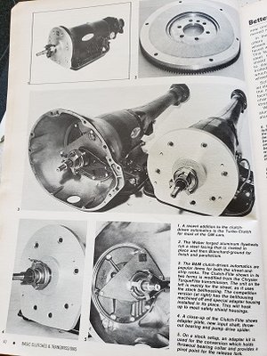

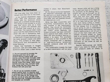

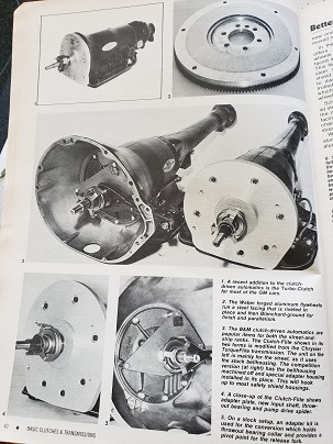

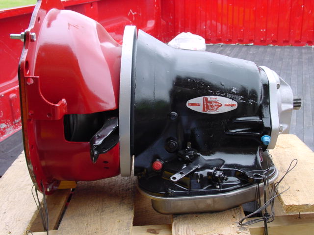

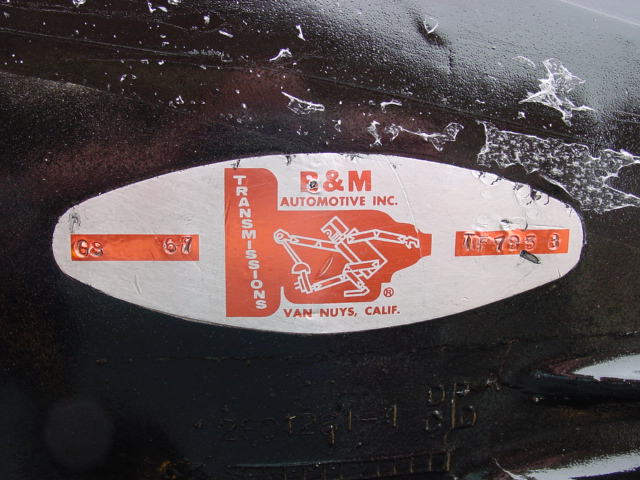

They were made in two basic forms - kits you could DIY and as complete transmissions by the likes of B&M, Fairbanks, and others. Of course, every company claims they invented them first.
The two popular ones were the 727 and TH400. There are also some Ford versions but rare. Back in the late 90's I was buying them (727) up and just stuck them on a shelf. The Fairbanks version is probably the best design but the B&M is a little more compact and pleasing to the eye.
The bell is cut off then the adapter is bolted on. There is no way to weld it on as it needs to be removable to assemble the trans. The pump bolts are used to hold it in place, much like today's UltraBell-equipped transmissions. I get nervous about it...but it seems to work.
Here's an excerpt from Petersen's 1971 publication on transmissions. I have a lot of pics and paper on clutchflites, lol!
