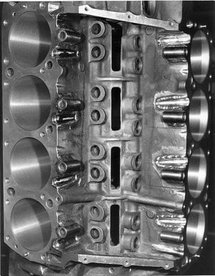

As far as cutting a 225 AL block down, that is an interesting idea. (Rob, I want that one I sold you back!) However the bolt issues have been mentioned. And there are those who don't have any interest in losing any cubic inches. If you were going to drop in the 198 crank, remember the crankcase needs some clearance on a steel block, also in the AL? There are the same issues with the normal AL block to deal with also, head gasket, bores moving around with higher power levels, 40 thousand overbore, rare block to find, bolts or studs, etc.
When they were de-stroking the 426 hemis in the 70s and 80s, they had started using low block 383s and adding 8 bolt bosses in the lifter valley. So, most anything can be done, limits are imagination, skills, cash, time and desire. Few slant folks have "all" those.
Great idea though!
