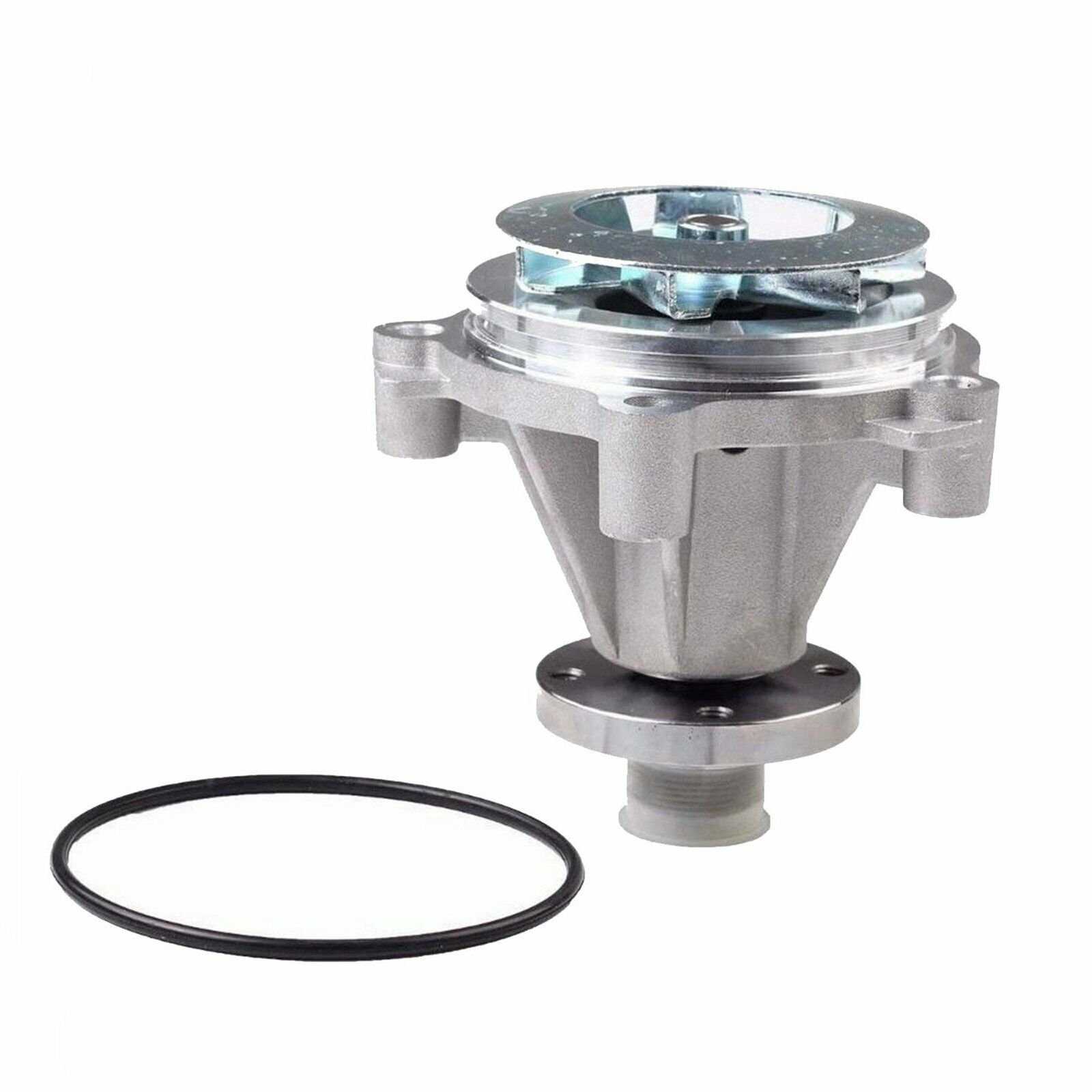

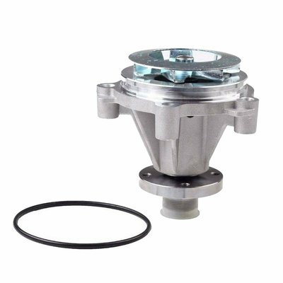

The real downside to the Slant, and other old Mopar engines, is the short water pump height. If there were another couple inches, it would be interesting to experiment with more modern pumps. There are some really nice, compact, and presumably efficient pumps out there...but they all tend to be taller than the old pumps.
