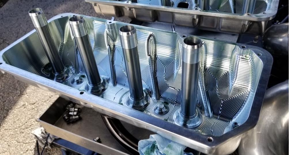

Here is the inside of a billet valve cover.
looks like you just let the machine follow the maze.

If I had known it was THAT easy......

It's not very hard, if you make someone else do it.
