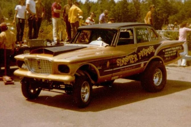

PostPosted: Tue Sep 01, 2020 11:03 am
Posts: 9111
Just for you, Joe... :wink:
:twisted: :twisted: :twisted:

PostPosted: Wed Sep 02, 2020 5:19 am
Posts: 419
ImageDon't be taking my idea from years ago!
PostPosted: Wed Sep 02, 2020 5:46 am
Posts: 9111
I just want to be like you in every way Mark!
Cuz you is so COOL!! :mrgreen:
It looks like your idea was to extend the front. What I’m looking at doing is moving the rear axle up.
We will also skooch the straight axle forward just a little in the existing wheel well.
It looks like I need another parts car... :lol:

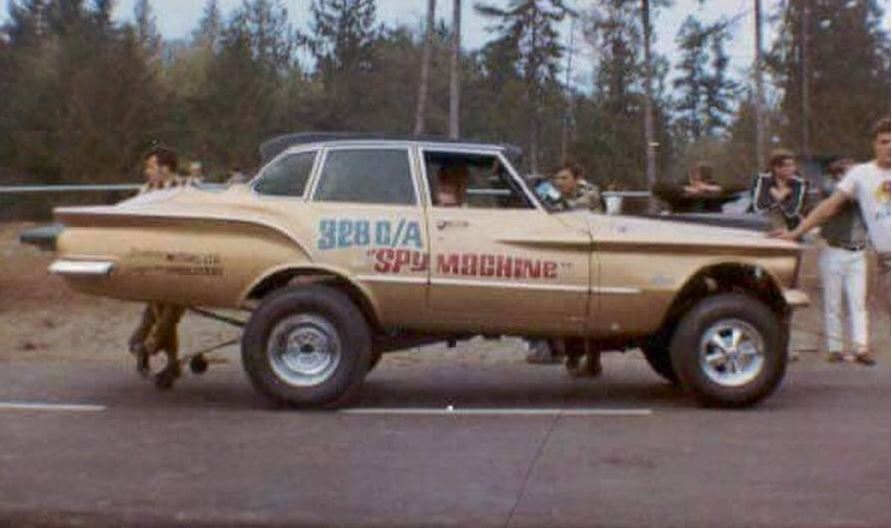

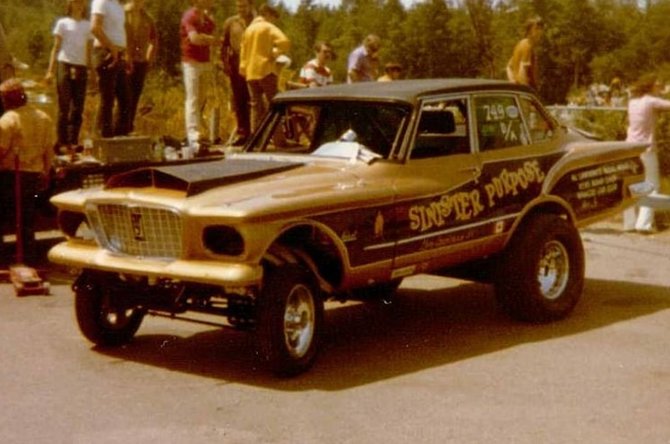

PostPosted: Wed Sep 02, 2020 8:15 am
Posts: 2667
As long as you are going to do this project, here are some examples of other crazy folks.
