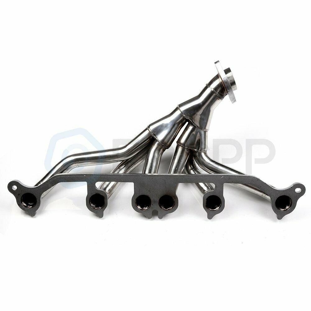

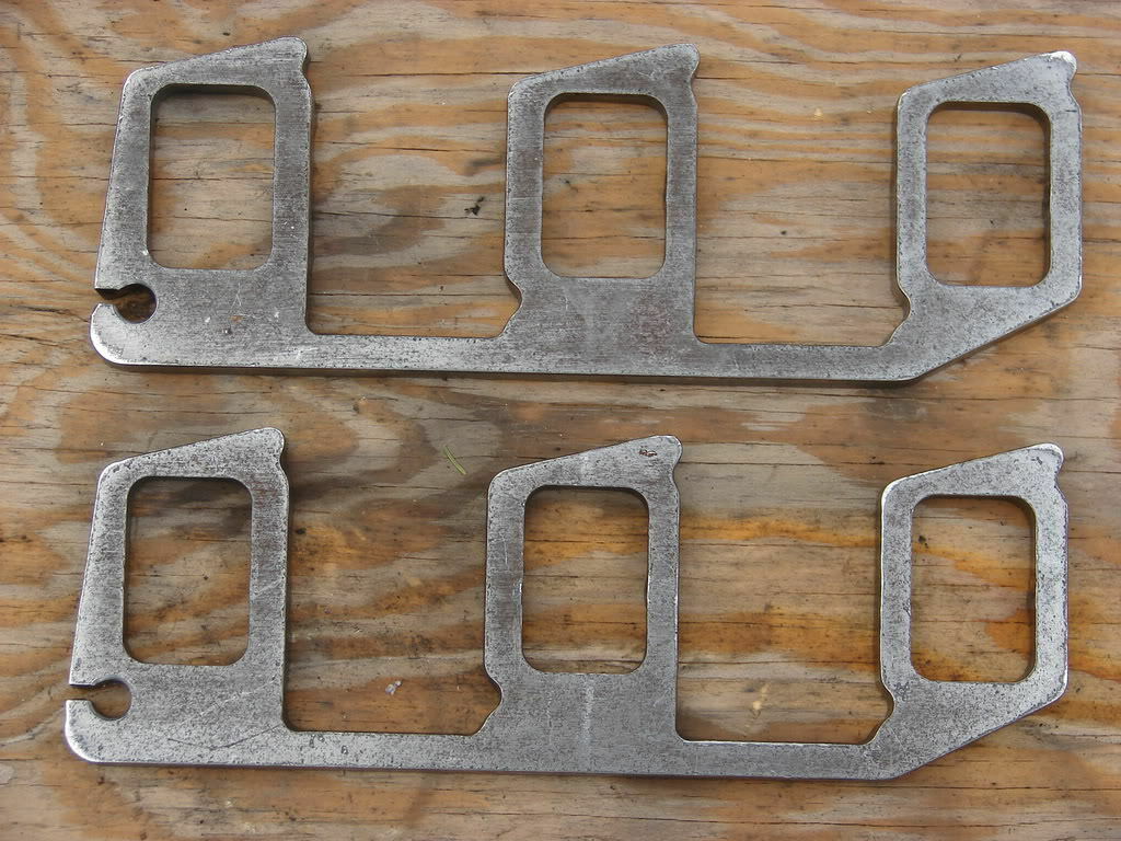

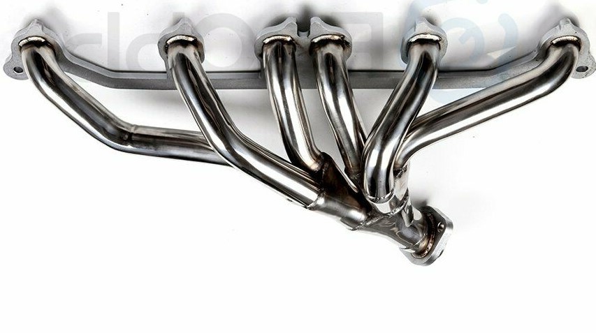

Here's a few pics of the Jeep header vs. the slant header and the head flange on eBay. Total cost about $110.

Yeah, I could be dreaming, but it sure looks like (1) cutting off the jeep flange, (2) dividing the header into two pieces at the primary/secondary collector joint, and (3) welding on some pipe to lengthen and the get the spacing correct up to the head flange is going to get you darn close to the slant header configuration. Then it's just a matter of welding both pieces to their respective slant head flange and finally welding on a couple collector extensions and flanges.
At worst, there might be some creative headpipe bending required to clear the starter, but any decent exhaust shop can handle that.
