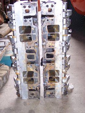

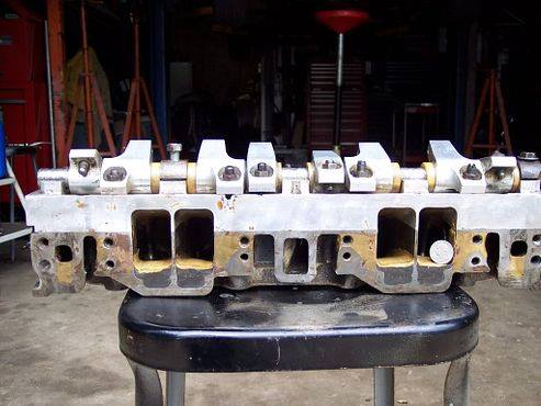

Here is what Wally Booth and Dick Maskin did with AMC heads in the '70s.
Cut the top of the heads, added a big slice of aluminum and then machined it.
You wanted to improve the heads, didn't you?

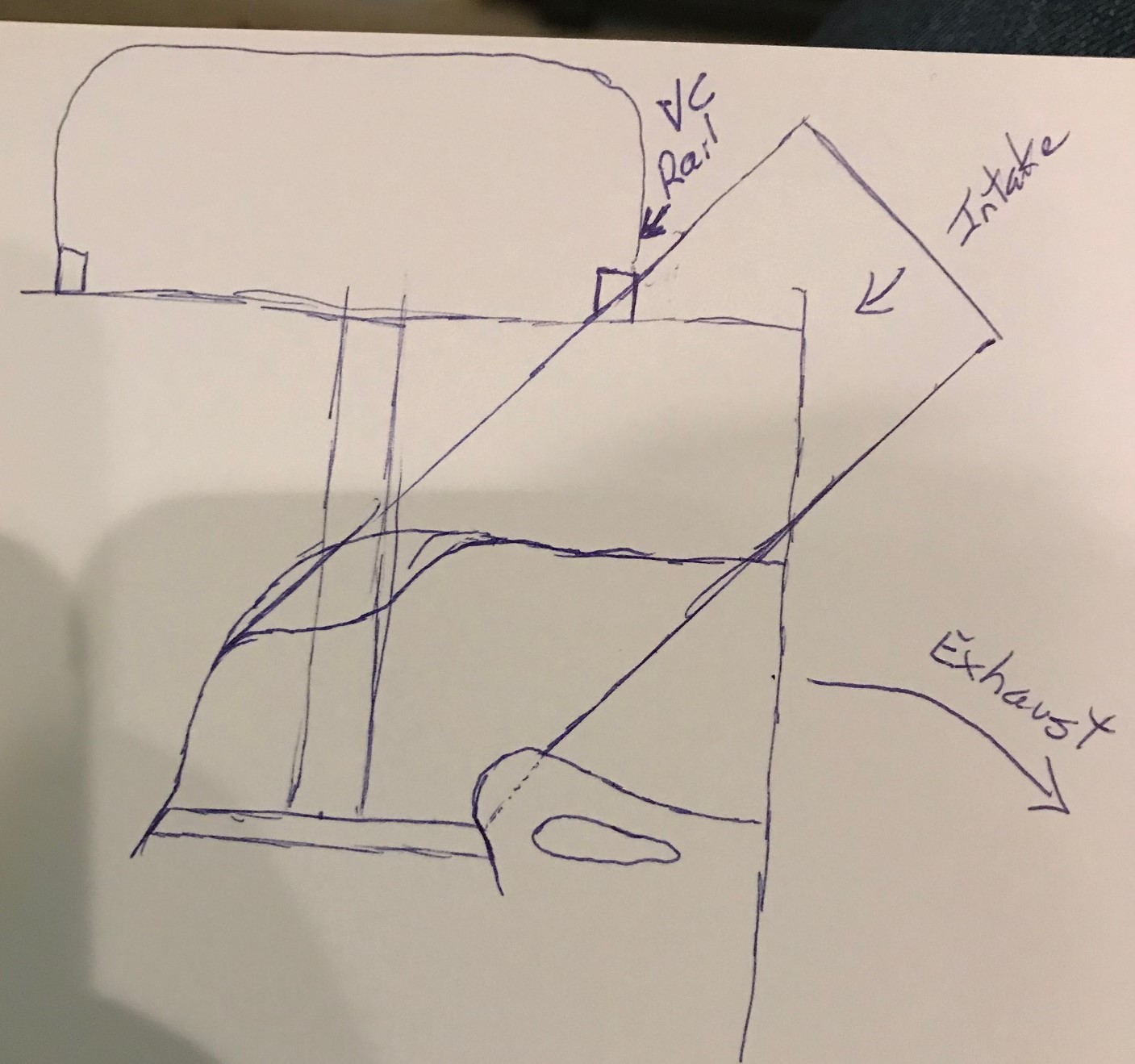

Right now I'm on a 7, 8, or maybe 9 race tour, with only one of those "in-town". I'll be racing the Nitro Nationals this weekend here in Tulsa, then it's the car show and Nostalgia Races at Arc City Kansas (Mid America Dragway), then Mokan for the Fall Hot Rod Reunion. And then maybe November at the Mopars-In-The-Park at Tulsa again. I just finished the Slow Pokes Reunion at Ardmore OK, and before that was Foot Brake class at Tulsa, and before that was SPAM DRAGS at Mokan, and before that was Knoxville. So, maybe I can get back on the head project this winter.
I have it set-up on the mill, but it started to move, so I need a better angle plate set-up to hold it still. That will be a machining project in it's self. My plan is to do one cylinder, and then cut it off, and send to local company for brazing. The head I have on there now is junk. If this works out, then I'll refine the geometry and do all six intakes. Obviously I'll wait until after the brazing to surface and put in bigger valves.
Here is the sketch I made to show a friend what I am trying.
