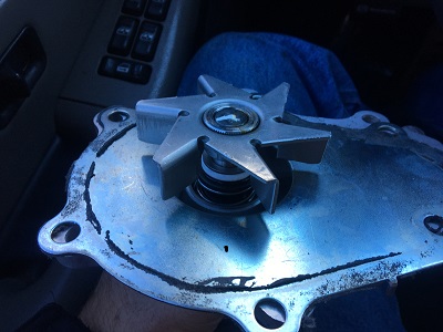

I finally got time to go over to Denny's and pull the 3rd water pump off of the truck. The bearings in the pump are not loose at all.No play is felt! I'll take a picture but I'm not sure what I'm looking at. The "used" water pump I put on the truck is working fine. Who knows for how long! I did remove the clutch fan and installed an old 4 blade fan we had laying around temporarily. I will install an electric fan for a permanent solution. I see nothing that can be causing this other than a seal or seal machining issue. I'd really like to know what it was.
And just for info. Joshie mentioned the Airtex water pump being one that had 6 blades, and thus may be a different manufacturer. So I ordered one and guess what? It came in as an 8 blade pump also from Mexico. The same place the last bad pump came from! So who knows.

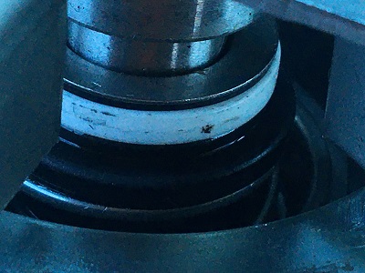

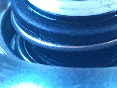

I was wrong about the 3rd pump. It actually had 6 blades. Still came from Mexico.
Here are some pictures. Not sure what I'm looking at?? :roll: :roll: It did look like the teflon (white ring) and the spring were up on the shaft a little higher than the "used" one I put in. Could that be the problem?

I can't see that well enough but it looks like the entire seal has walked up out of the housing, which is what I'd expect. But, I can't see it well enough so I could be wrong.

So does the spring hold tension on the seal?

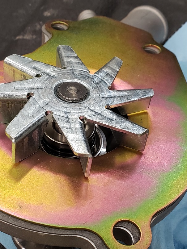

I actually need to shut up because I can't see your pic well enough and I also don't know enough about 225 pumps to start handing out advice. For what it's worth, here is a new 8 blade pump...I think it is a Gates but not sure. The spring, I think, is intended to hold the seal in place. It looks like your top collar is moved toward the impeller more than mine. But that could be a difference in manufacturer, too.
If yours is bad, I'd try taking it apart and looking for where it failed.

I think that seal belongs on the other end of the shaft. It shouldn't be on the impeller end, but the housing end. It's a face seal that is spring loaded against the housing. If you have a press you can take it apart. The 1966 Dart and Coronet manual shows how.
