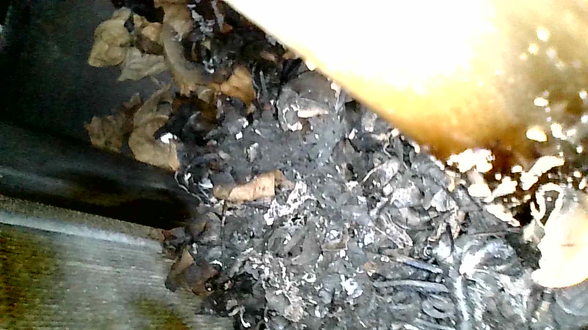

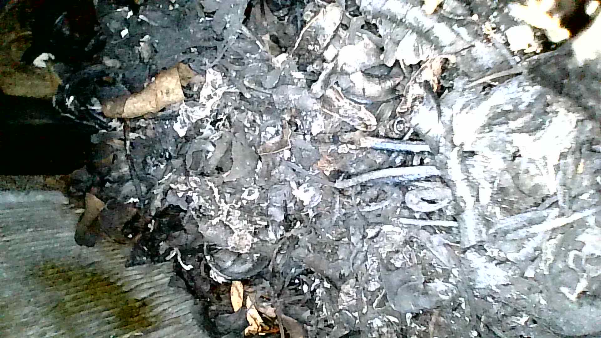

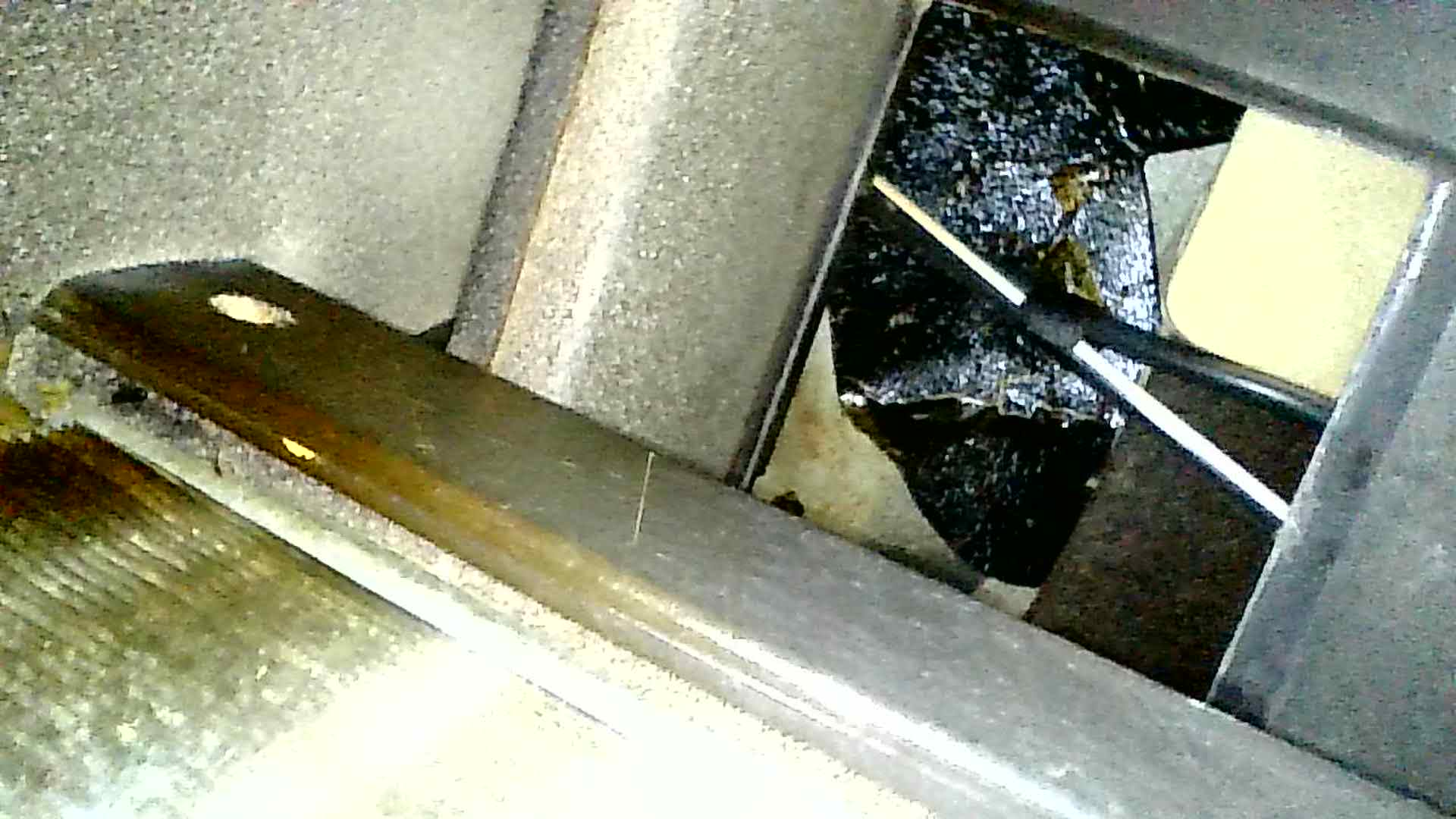

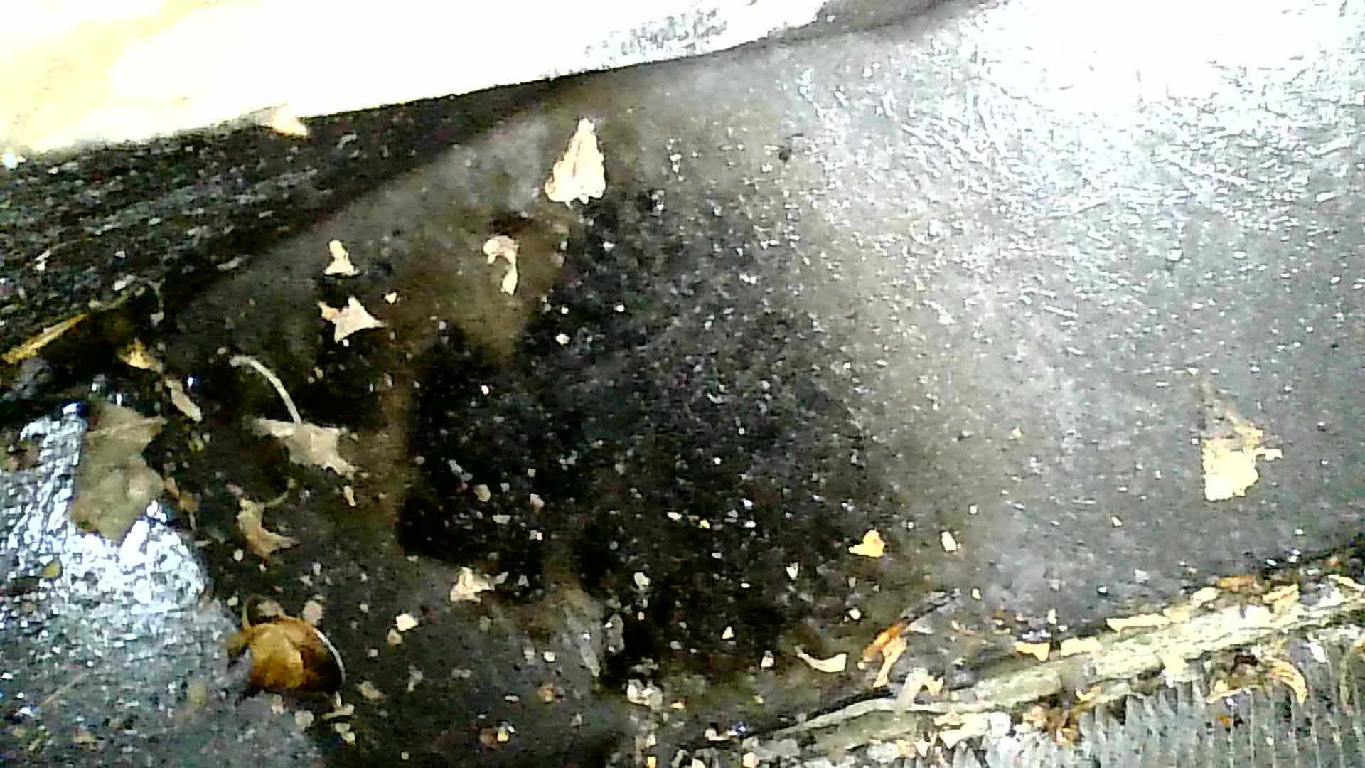

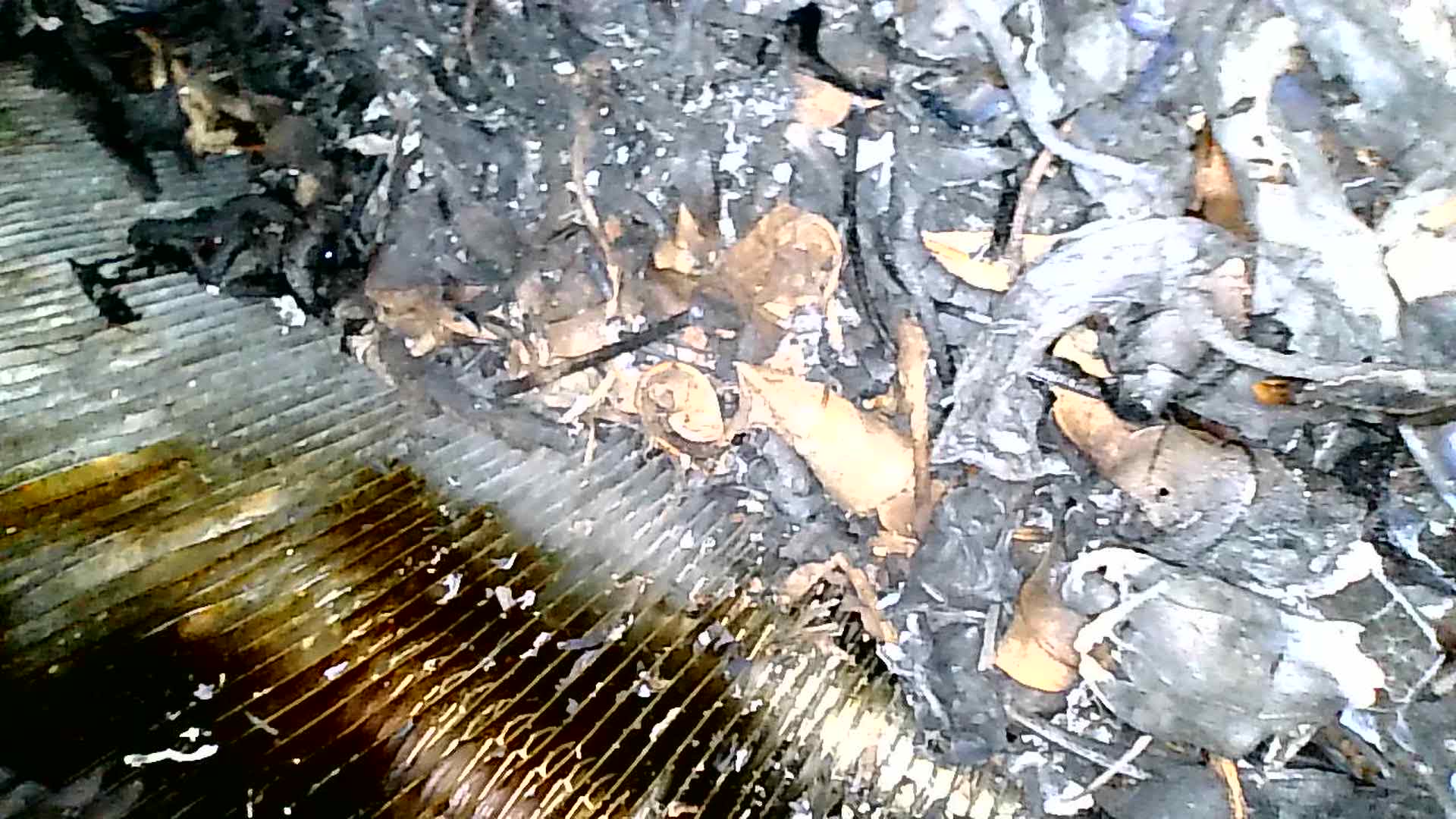

We've made some good progress over the past couple of weeks. However, an event yesterday made us stop and take a step back for a minute.
We discovered that this car has some unintended supplemental heating installed. And by that, I mean that the evaporator/heater box was full of dried leaves, which caught on fire from the blower motor resistor. This filled the car with smoke like an old Cheech and Chong movie. Luckily the damage was very minor and I happened to be working in the area of the glove box, so I had the tools right in front of me to get to the heater box ASAP and put out the fire.
This is the bottom of the heater box, looking in from the opening for the blower resistor toward the passenger side of the car. The evaporator is in the upper left side.
Similar to the previous pic, but looking almost directly down from the resistor opening.
The bottom of the heater box, from the opening of the resistor toward the center of the vehicle.
The heater box recirc door. I expected the foam on this door to melt but it's in good shape.
The bottom of the heater box after the charred leaves were removed. We can see the hot spot for the fire. I did remove the last few small leaves before I buttoned it back up.
