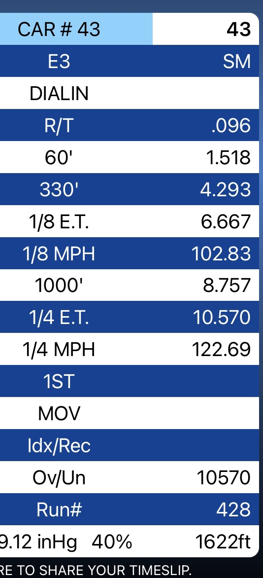

I made some true 1/4 mile runs yesterday at Tulsa Raceway Part in the SDRA club race. Just as I had hoped based on 1000 ft time, the Go-Dad-Go ran mid 10s. The track was not the best and the tires spun on every pass, so the 60 ft times are off. I imagine with some decent air and a good prep, it will run 10.40s.
I think with some dyno time I can get it into the 10.20s.
Then methonal!! :lol: :D
