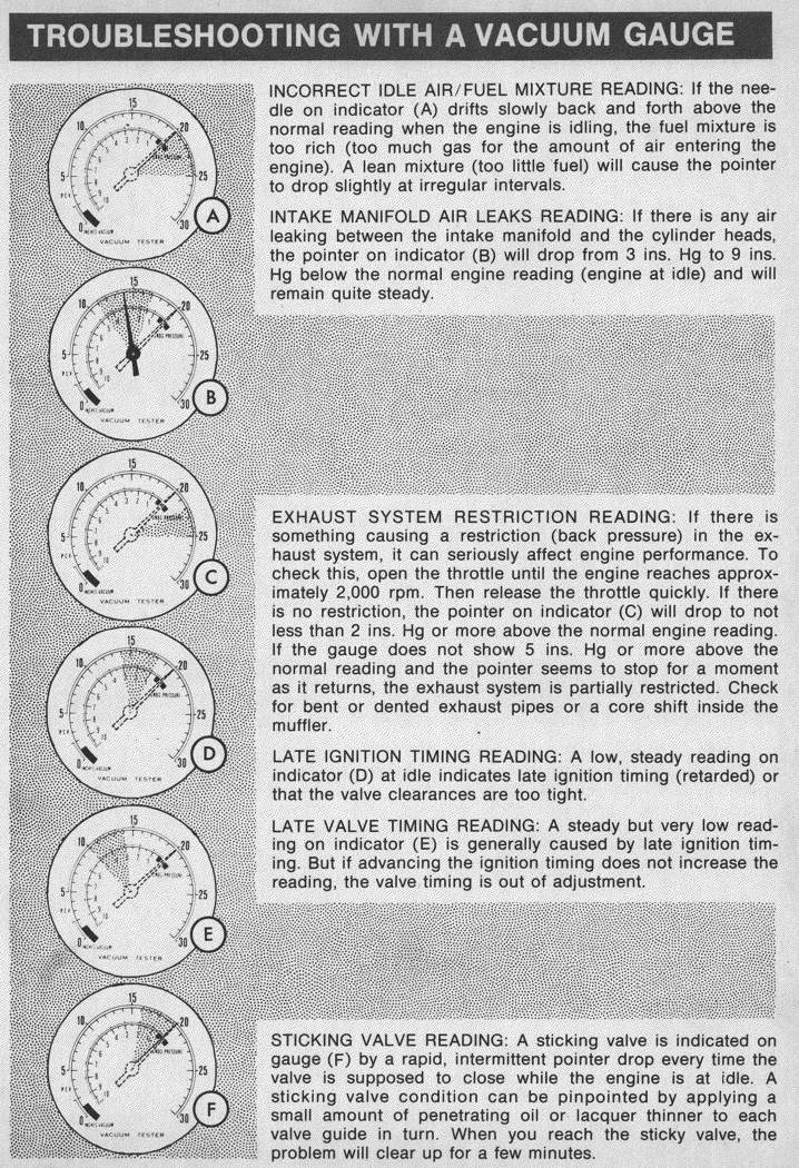

PostPosted: Thu May 13, 2021 5:30 pm
Posts: 10448
I checked for any back pressure under load, and there was none to speak of, so it's free flowing.
FYI,
Brian
How do you test/ check for that in the exhaust?
PostPosted: Thu May 13, 2021 8:28 pm
Posts: 427
Location: SW PA
With a backpressure gauge, silly! No, really, just a low pressure gauge kit with an adapter that screws into an O2 bung. Generally anything 1.5psi & down is considered good testing a cat-converter. More is worse, less is bettah!
PostPosted: Thu May 13, 2021 9:38 pm
Posts: 25088
PostPosted: Fri May 14, 2021 6:31 pm
Posts: 427
Location: SW PA
Ja, that's how We used to do it, thankfully no longer. Still works, though for moving obstructions that don't rattle, the real-time direct pressure rocks.
PostPosted: Mon May 17, 2021 4:20 pm
Posts: 2132
Location: SF Bay Area
Yep, exactly, used the O2 bungs in each downpipe. Note: I tested it under real load, not just revving in the garage, but driving it. Ran the pressure line through the firewall, and duct taped the pressure gauge to the dash by the radio.
https://tinyurl.com/yynpj4v2
PostPosted: Sat May 22, 2021 4:14 pm
Posts: 10448
So basically just a vacuum / pressure gauge line into the O2 Bung?
Sounds easy enough!
Thanks for the gauge reference tuning chart Dan!
