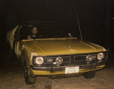

bilingual (English/Afrikaans) controls and displays, sold by Chrysler South Africa.
That would be interesting to see. I know its nothing special to people who live on the veld, but I've never seen one.
Here's me in 1995 at the wheel of Bob Hodgson's, which he brought with him when he moved from RSA to the UK. The paint was fine; that's frost.
Cool! I love all the foreign models.
