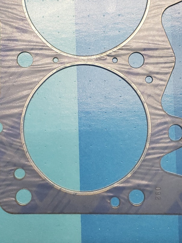

Not compressed thickness, compressed volume.
The average gasket (not sure about Slant Sixes) is not a perfect circle, nor is it the bore diameter. So the compressed thickness takes all of that into account and gives you what really matters, the volume in its installed condition.
yea but to get the compressed volume one starts with the gasket diameter and the compressed thickness of the gasket and the formula shown below,
V=pi*radius squared*height
the online calculators use the diameter of the head gasket to get the radius and the compressed thickness of the head gasket to get the height, the compressed gasket volume is then just doing the math using the inputs.

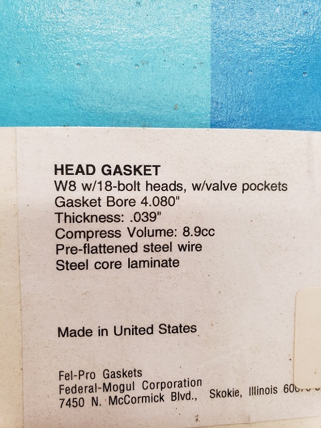

PostPosted: Tue Jan 11, 2022 4:30 am
I said from the start that it won't make much difference.
But, why not use a more accurate number when it's available?
