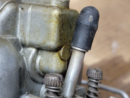

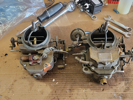

It has been a while since I posted an update. I replaced the timing chain and gears, after which I needed to move the distributor one tooth and now I hear the points snap at the center of the adjustment rotation. The truck still would not run well at all. Like it was not getting enough fuel, which the new plugs also indicated. Because the fuel in the tanik is over a year old I put an electric pump in and fed fuel from the 5 gallon fuel tank for my lawn mower. When I turned the pump on I saw a 1/8" stream of gas coming from the bottom of the carburetor fuel bowl. After removing the carb and inspecting it there is a plug shown in the picture that is leaking fuel out of the fuel bowl. I have the original rebuilt manual choke carb for the truck, so I swapped the choke components over and now the original carb has an automatic choke. The carb pictured on the left is the original carburetor. The carb on the right according to the Carter carb manual and its internals is a true Super 6 carburetor. Too bad the bowl leaks. The battery is dead (my fault) so I have to wait to see what happens. I forgot I needed a return spring for the original carb. Not being able to find the bracket I made a new spring anchor bracket. While fitting it I saw a drip from the original carb. Is there a problem with this plug, and if there is, is there a fix?
File comment: The carb on the left is the original carb. On the right is a later Super 6 carb with the leaking fuel bowl.

1) Are you still using the electric fuel pump? If so it may be delivering excessive pressure to the carb, causing leaks. 5 to 7 PSI is the max fuel pressure commonly used in a carb. Some only tolerate 2 or 3 PSI.. I believe your BBD's will do ok with 5-7. That needs to be addressed first. I would go back to the last known combination that did not leak in terms of fuel pump and carb setup. Then start searching for the vacuum issue.
