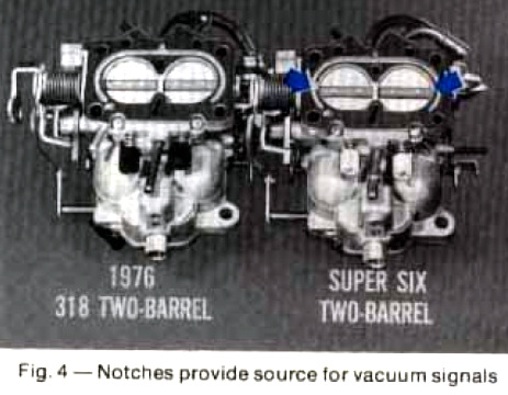

They claim that the 1976 - 77 318 throttle body did not have channels cut from the intake-side into the curved channels on the bottom surface. But the "new" super-6 BBD does have them, and hence the gasket doesn't need the notches.
