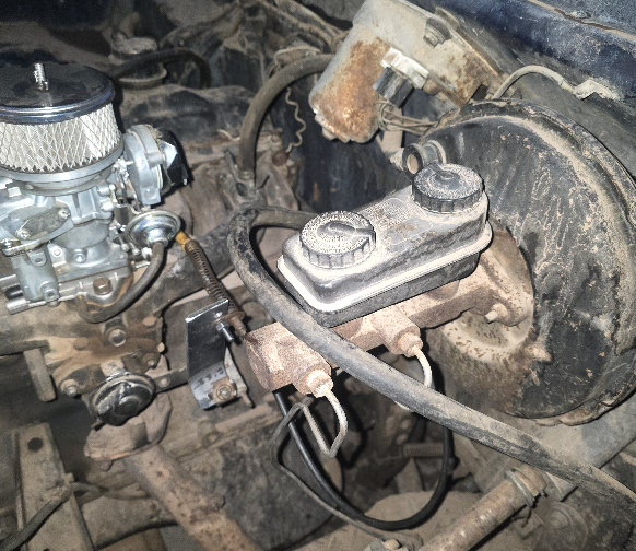

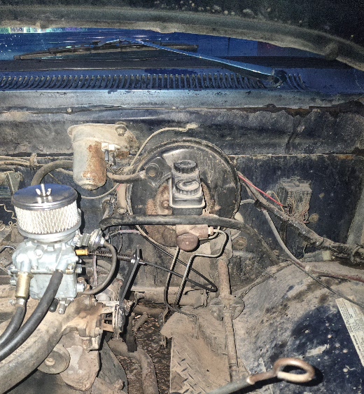

So I somewhat got it here are pics. If I push the gas pedal to the floor the carb does open all the way an the response does feel better. It does seem to stick an the beginning of the pedal. But I'm thinking that's because I got a junkyard cable with the plastic parts from the top of the cable are broken and some of the metal strands are sticking out, I cut them sorter so it doesn't get in the way but that might be my issue. Let me know what you guys think.

If it is opening the whole way, it should run much better.
When I push down the gas pedal it does look like it. But it does stick or get hard at a certain point. So I'm looking at getting a better cable since the strains are poking out of the spring which should also help.
