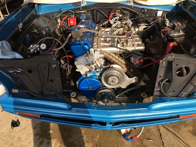

PostPosted: Mon May 17, 2021 6:15 pm
Posts: 9115
Getting in to the problem! :D

Rick, what got bent? The alternator bracket or the oil pump mount?
PostPosted: Tue May 18, 2021 2:41 am
Posts: 9115
Just the aluminum bracket. It was 1/4' thick. I have a piece of 3/8" and will make wider through some of the areas that I can to stiffen it up. Doing some quick measurement, it looks like the water pump pulley needs to go back" .080 or the balancer need to come forward .080" . I hate to move the water pump because I would need to do it to every one I ever put on the engine. But I hate to remove the balancer and add a spacer because of all the oil pump drive stuff I need to remove. But I will probably pull the balancer. Cutting 3/8" aluminum by hand is slow task too! :(

Wow, I have pics of that mount. Hard to believe it bent. Do you think you could try another water pump pulley? Maybe the one you have is just made a little 'off'.
PostPosted: Tue May 18, 2021 9:08 am
Posts: 9115
I think the fan belt came off and then went into the oil pump belt. Once it got there the slack for the fan belt to pass around had to come from some where. So it just bent the bracket forward.
Yes plan to try another pulley
