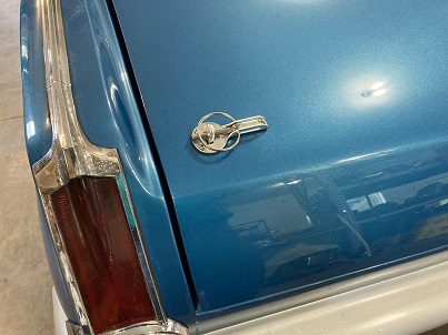

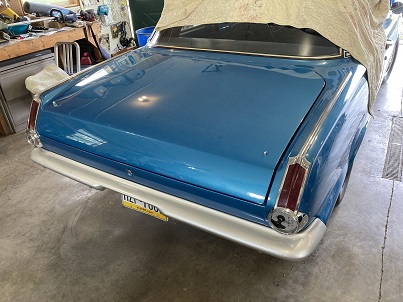

Trunk lid is all done. It came out great I think. Painter said it wasn't perfect but he's a perfectionist! :D :D
I brought home, installed the alignment pins in the holes and bolted it fast. Installed the hood pins

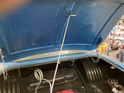

and a 5/16" solid aluminum rod for the prop.
