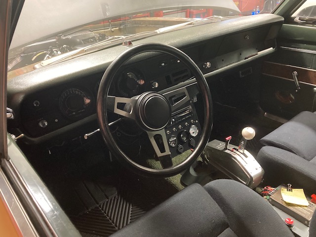

The OE steering wheel on this 68 Barracuda is just absolutely perfect. Has a nice shine, no cracks.
I am wanting to drive the car aggressively and I felt that a thicker steering wheel rim would give better
turning grip and at the same time I would not be stressing the nice OE steering wheel. I like the way the Tuff Wheel
looks and feels.
