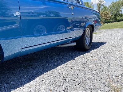

While I have license and insurance on the car, running with open headers through the neighborhood isn't really nice, even out in the country. Since We have great neighbors, I took the car over to my friend "Speedy" and had him install exhaust on the car. Dual 2 1/2" off the headers to a nice tapered Y pipe, then single 2 1/2" into a AAR Cuda style muffler. In and out on the same end and then exiting in front of the drivers side tire. It is made so that the whole system can be taken off in about 2 minutes without unclamping anything. This made it much nicer to drive and also helped me to get much better O2 sensor readings at low RPM. Before I only got good readings at WOT from about 1/2 way down the strip on.

Here is the exhaust look. :D I'll let you know how it runs after my trip to Mason Dixon tonight.

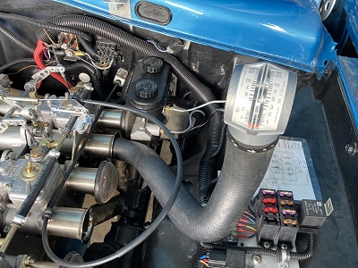

I also got the new Synchrometer that works well for tuning the carbs. With the location of the Master cylinder you can't get straight onto the trumpet. So they sell a hose to slip into the trumpet and the Synchrometer. Me being a tight wad, I looked at my spare lower radiator hose and it was an exact fit for the job! :D So it serves two purposes! Plus it was 1/3 the price and in stock! :D

Do you need to tune each barrel / throat individually or just 1/3/5 and then replicate the settings on 2/4/6?
PostPosted: Mon Aug 29, 2022 2:05 pm
Posts: 9329
Only need to get a reading on one barrel on each carb to get them synched.
