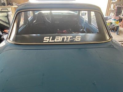

New race sticker should be worth a couple tenths! :D Thanks Rob!
