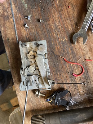

I did notice that my RH door was starting to close awful hard. So I spent a couple hours messing with everything I could think of to no avail! So I removed the entire door latch mechanism from the door and did some more head scratching. What I found was the star part of the latch mechanism is or was originally tight on the shaft it goes on. Mine was loose enough that it would move around and not latch properly. If it did latch then it moved backwards and left the door get loose on the frame. So I took it to the shop and cleaned it up and welded that bad boy right in place. Reassembled everything and it works like a dream! Wow, now I want to do the other side since this one works soooo nice !

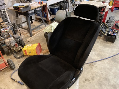

The process has begun! Removed the lightweight race seat and installed the Neon Seats I had in the attic. Probably added 50# of weight so I may not even be able to run in the 12's. But I can take my wife for a spin if I want to. :D :D Just as soon as the RH side seat belt assembly gets installed. Now that all the brackets are done and mounted, I'll removed them and clean them and paint them black. Clean the seats and finish dying them black also.

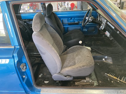

The second seat is mounted and they are both dyed black. Passenger side shoulder belt kit will be here in a couple days.

What does the dyeing process involve?
I suppose you cannot dye it from say dark blue to light charcoal.. has to be dyed darker...
PostPosted: Sat Apr 22, 2023 6:36 pm
Posts: 9488
It is just a simple spray can process. I think it was "duplicolor" brand. I went from Gray to black and just made sure I went at it from different angles.These seats had a kind of "brushed" texture and the texture is a little stiff until it gets sat on a few times. I actually took a small soft brush over the seat as I sprayed the 3rd coat onto the seats. For 15 bucks they look great. I'm not sure how it would work going from a darker color to a lighter color?
