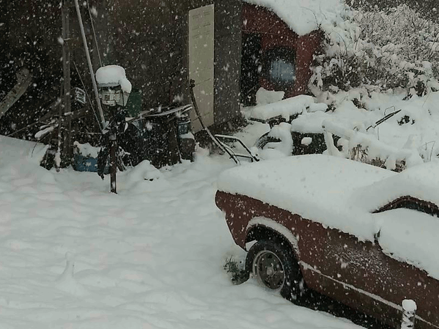

The skunk works, were all the magic happens.
Not much magic happening right now, in parts collecting mode.
