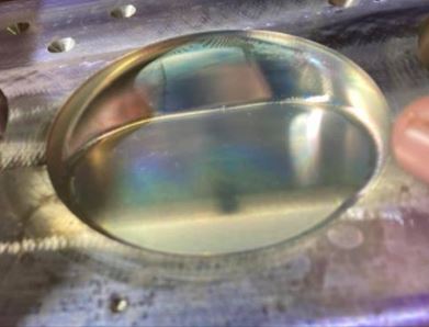

Mr. Maw has been posting more video. Chambers are shaped, progress is being made.

He mentioned making three different versions, but I don’t remember the details.
Someone asked him about sharing the CAD files. I don’t recall what his response was.

Rick, I didn't join facebook till this year.
I have met some very good people and have enjoyed most of the experience.
You have to filter out a ton of crap, but for me it has been worth it.
I will snip some pictures of Robert's work and post in a minute.

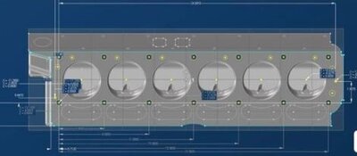

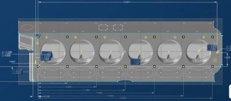

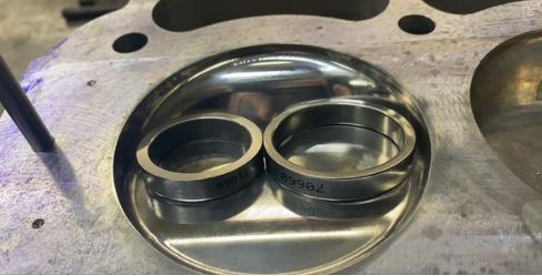

Robert's head pictures.

PostPosted: Thu Dec 31, 2020 3:37 pm
I don't think making a head is that tough...it's a lot of machining but not tough.
Except for one thing....water jackets. Those are internal while the rest of the head is external. So the challenge in making a head, or welding up an adapted head, is getting the water jackets to not leak and to be properly placed. The beauty of casting is it allows you to make internal passages.
So will his head fit? Yes. Will it run? Yes. Will it run for hours and hours with no cooling issues? That's the $64,000 question.
