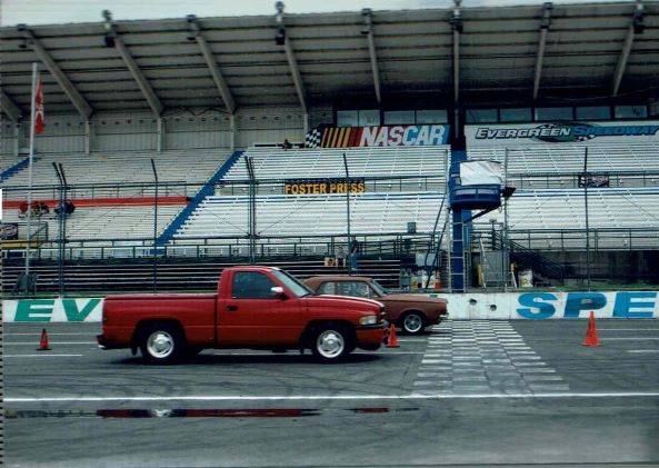

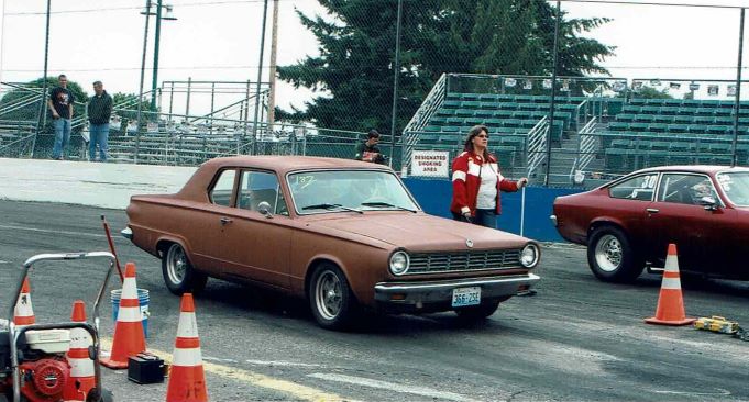

One time, at the race track...
So the next time a a magnum guy says that the slant is "not worth the money"...
On the other hand a 350 powered Vega is hard thing to catch and for that matter, so is a 1.8L Civic with nitrous.
