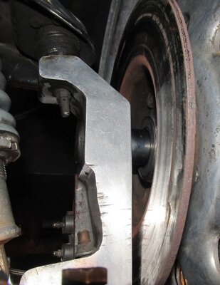

Many have asked about the spindle mounts, well just one really...
Here is the spindle on the front end.
You can see the axle shaft going into the back of the wheel.
And then the wheel slips on the stub.
Inner and outer bearings are in the wheel hub.
This is an image when the Colt got to me.
I have new rotors, ball joints, polished aluminum mount, etc.

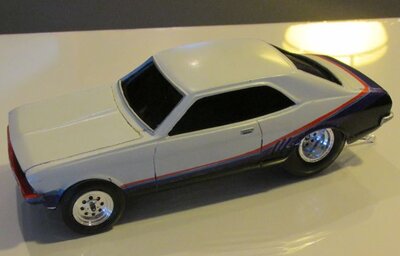

I have a friend down here in Texas, Bama Brown. Radio talk host with KASE, Dripping Springs. He is a pretty neat guy. He has been on Iron Resurrection TV show and he is building homes for First Responders on his property. Anyway he told me he had something for me and this showed up in the mail today. It's a scale model of my Colt! I was blown away as I unwrapped the packing. Who does that anyway? And oh by the way, we are face book friends, I have never met him face to face.

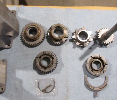

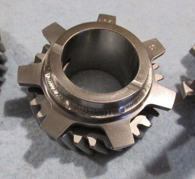

Here are a couple of images of the work.
I had my main case steel bushed for the countershaft support.
It's an all aluminum cased transmission.
2nd, 3rd and 4th are faceplated.
I have a syncro for 1st.
