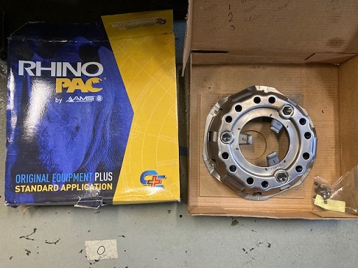

Tt is an AMS Automotive 05004 purchased through RockAuto,,
The kit came with: all metal TOB, 10 inch disk, PP and a bronze pilot bushing.
I had it bolted up to the flywheel to check the PP clutch finger height, and the best I can measure, they are all the same height.
The staking on the adjustment bolts looked OK, welded them for assurance.

The link you reference has the 'ol Borg and beck 10" cover that I had expected to see. the one you have does not.
I am sure it will work well.

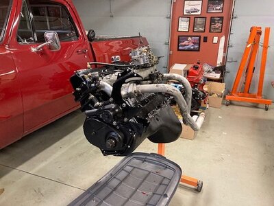

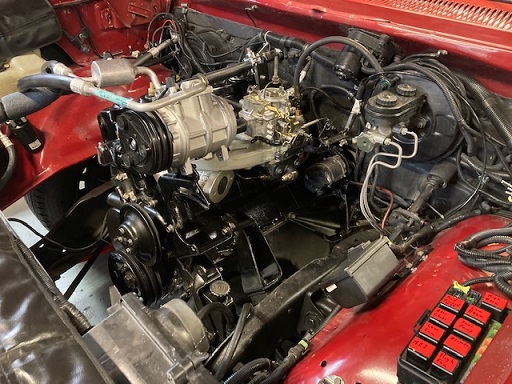

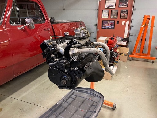

Andy AKA Andy's GT stopped by and was helpful in getting the motor back into the 83 D150.
It is a long reach dropping the slant back in to the 83 D150 and it is helpful to have a person up top working the hoist and someone down at the transmission guiding it back in place.
Spent the past few days re installing the: alternator, power steering, radiator, exhaust system, belts and hoses.
Originally I was only planning on fixing the clutch and maybe changing the cam, did that and a lot of general under hood cleaning.
I drained the a833 and need to get the lube to re fill it, other than that I believe I have everything. Tomorrow should be the day I get it re started.
