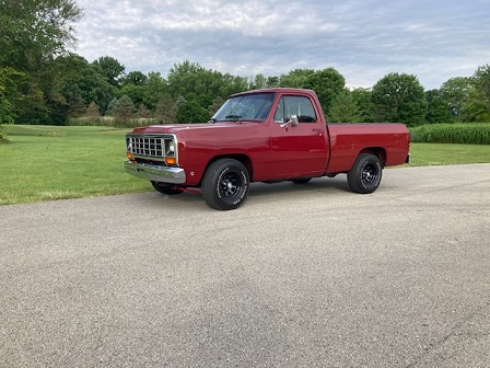

Author:  DadTruck [ Wed Jun 23, 2021 6:01 pm ]
Post subject:  Re: 83 D-150 Project
The 83 D150 has been back in use as my daily driver for about 6 weeks. I have put 1573 miles on it since the cam and clutch change. M and I have have taken a couple of nice trips in it. One to Middle Fork River Forest Preserve, near Rantoul IL. That location is designated as an International Dark Sky Park,, meaning that there is nearly no manmade light pollution, so it is really dark at night and the stars in the sky are really visible.
This past Tuesday we were in Santa Clause IN at the Holiday World water park with grandkids much fun. The D150 has done fine, no issues. Cruses on the highway just like before the cam change. The only real differences that I notice is with the prior larger cam, when pushing the RPM's through the gears one could feel a surge at 2800 RPM where that cam cam in. The new cam has a bit more push right off of idle then is smooth as the RPMs go up. The idle is certainly smoother and with the new cam. The clutch-transmission is great, shifts nice and smooth like it should.
Today I hooked up the vacuum advance to the distributor. That is about the last thing on the list. Tomorrow I go back on the 68 Barracuda to-do list.
