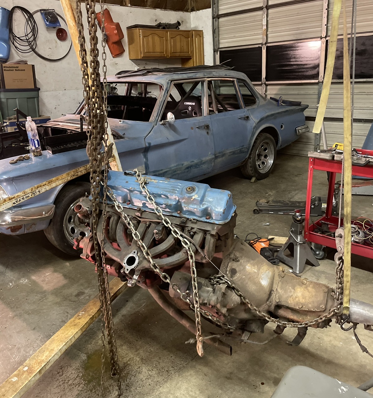

ToadRacer got a LOT lighter yesterday! :lol:

We decided to LS it.... It’s kinda Adams’ thing... :twisted:

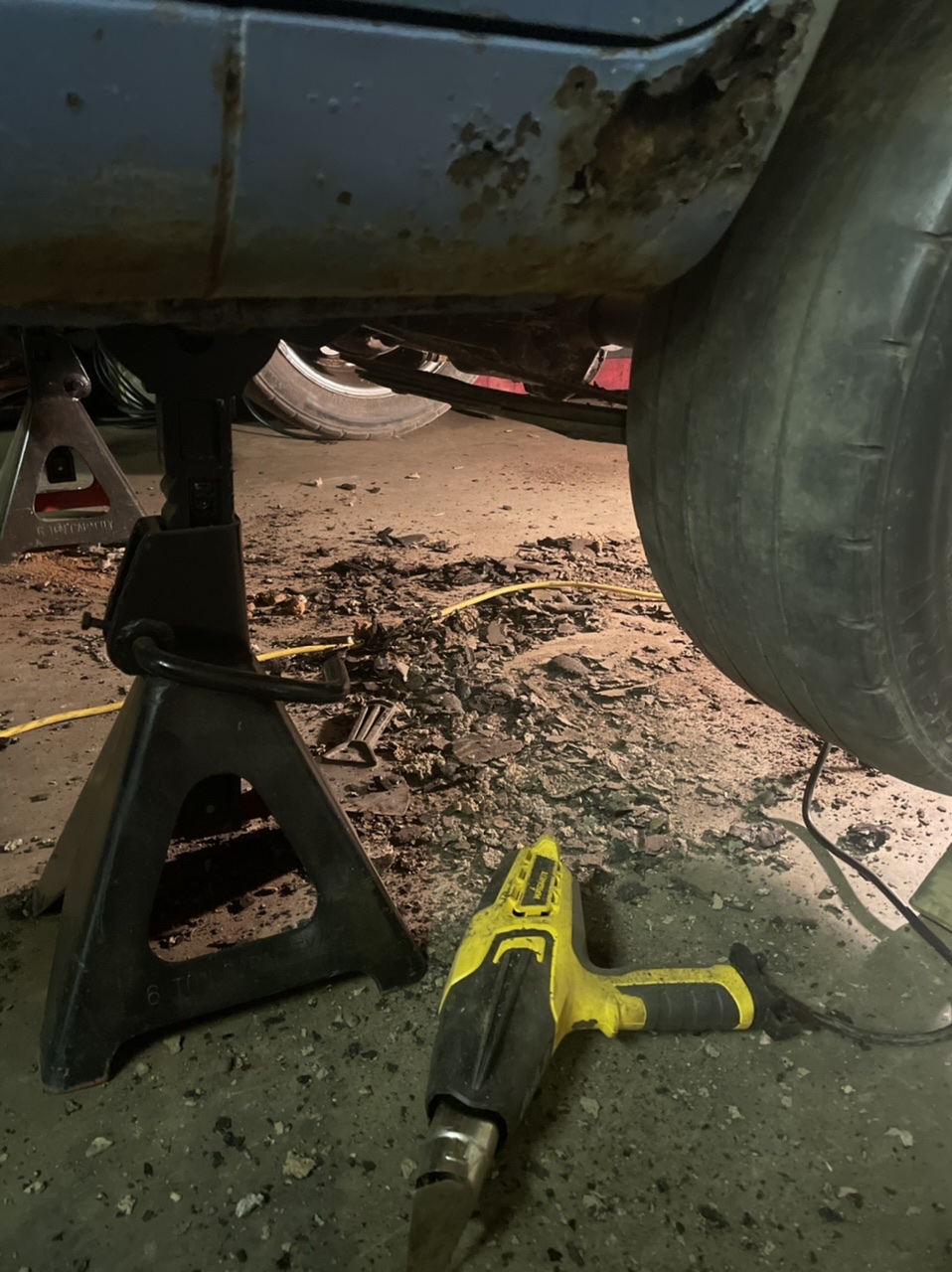

Getting the car ready to take to Adam’s I have scraped another 22 pounds of undercoating. There is still more to go! :shock:

Wow, 22lbs ain't nuthin'. Good work. Every 50 lbs or so you take out of the car, you can feel it on the road and the track/course. Keep at it!

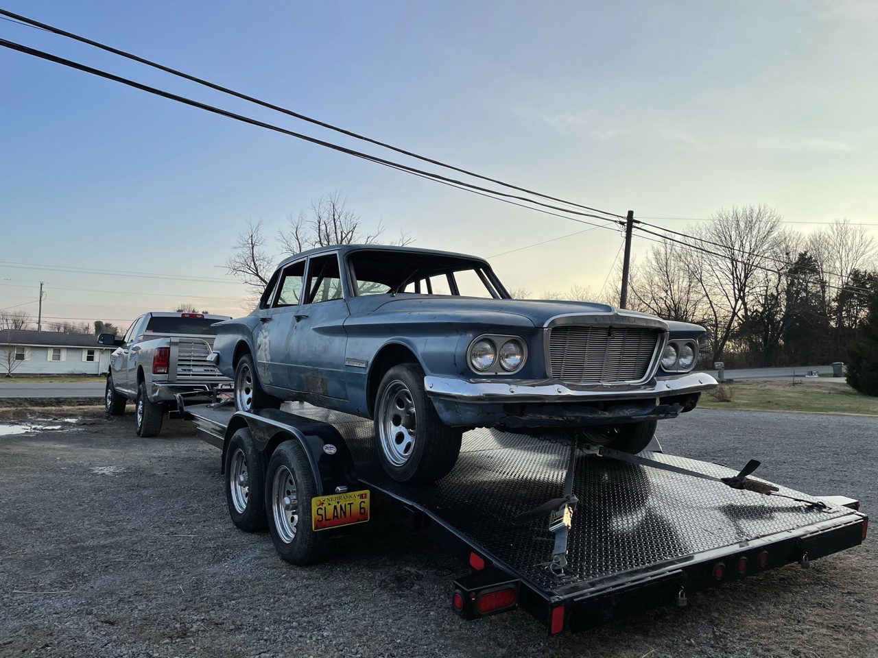

I took ToadRacer to Adam’s last night.
He didn’t tell me his narrow alley is a dead end! :shock:
Turning around the Ram 3500 long bed quad cab towing a 20 foot car trailer in there was.... ummm... interesting... :lol:

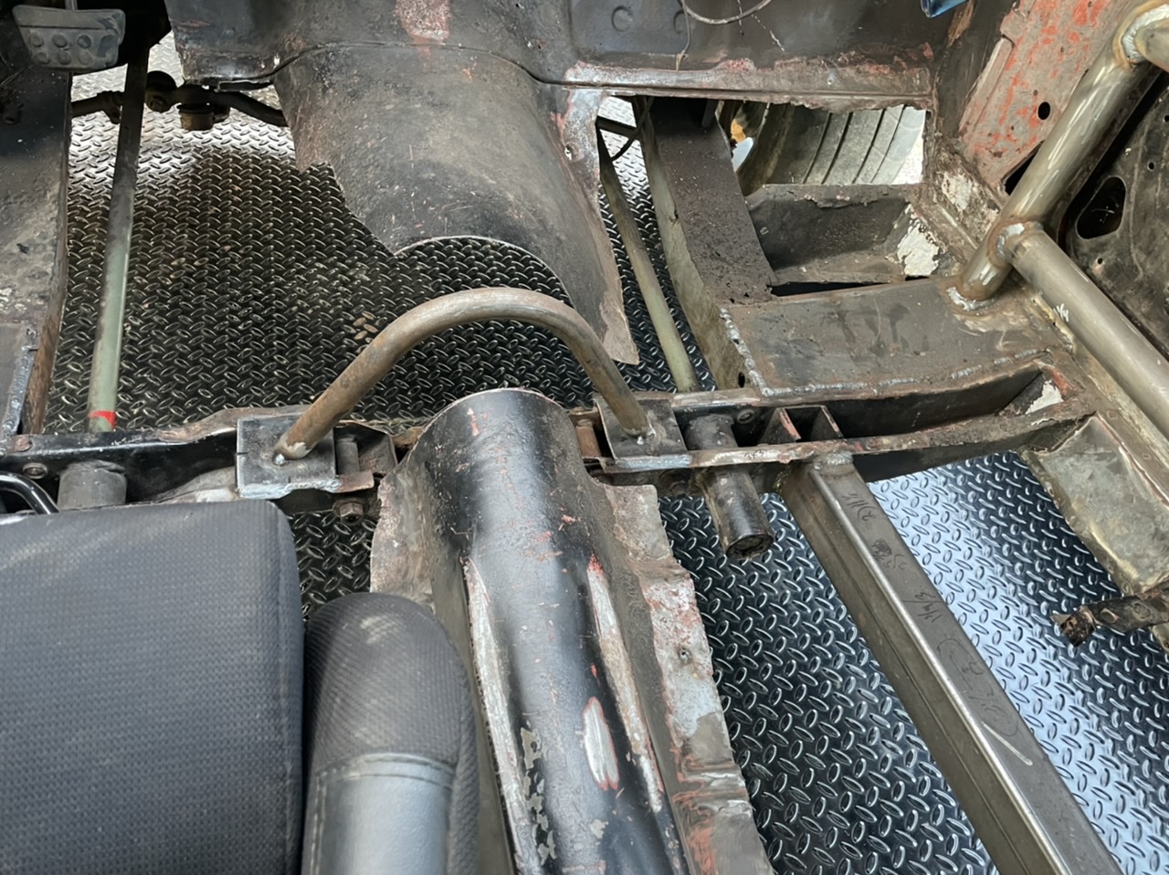

Nice!! Note that a T5 on a 63-66 A-body needs most of the upper X-member cut out, and at least 2" of the very top of the X goes away. Rebuild with rectangular box tubing. I can give more direction later...
I thought I had posted this pic before. Will this do, Lou...?

That looks plenty high enough. I might have used larger diam tubing, or I would tie it into the steel floor for good overall body rigidity.
https://www.slantsix.org/forum/viewtopi ... 20&t=64912
Find step #6
That tube should be fine. Tie it into the floor.
Too bad you guys are putting a GM v8 in there.
