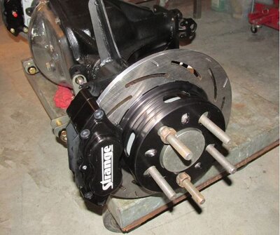

Dana rear end is together and brakes are mounted.

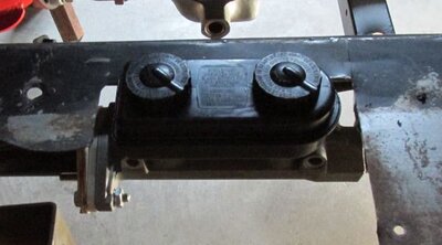

New master brake cylinder test fit and I am building the adapter.

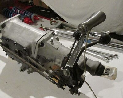

love that shifter! is the case and tail house all aluminum?

Author:  hyper_pak [ Sun Mar 07, 2021 6:55 am ]
Yes, all aluminum.
81 lbs. vs ~ 120 for a steel box.
Side cover is steel and Shifter is Hurst Ram Rod inline with reverse on the separate lever.

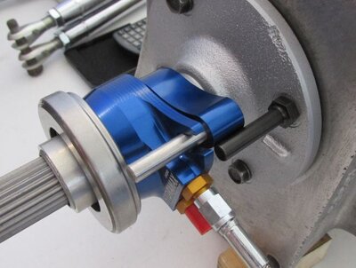

I found a kit for my Airheart master cylinder and I am using that for the clutch.
Purchased the American Powertrain hydraulic release bearing.
