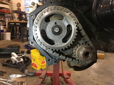

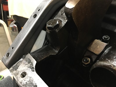

Here is the picture of the font of the engine.

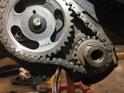

Here is the slack I have with 2 new gears and chain.
2 new chains and a gear set will be here tomorrow. Mayb one of those will be better but I am not getting my hopes up. :?

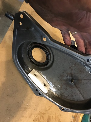

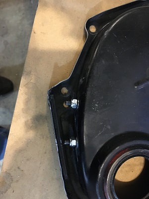

Took a couple hours of cutting, sanding, fitting.... repeat several times. But I got a decent fitting chain guide/guard installed in my timing cover. I have it so timing cover drops into place. No real tension on the chain. My assumption is that as the chain stretches, this guide will keep all the slack in the right place and not allow the chain to flop all over the place. I put some silicone between the guide and the timing cover to stop any leaks. Countersunk bolts and Ny-locks hold it in place. Here are some picks. Time will tell if it works.

I never liked the idea of a steel chain rubbing on any kind of plastic.......

Pretty cool solution, Rick. I hope it works well for you.
PostPosted: Sat Dec 19, 2020 10:13 pm
Looks good! Now I'm thinking about something of similar shape that's hinged on one end and has an adjusting screw on the other.
PostPosted: Sun Dec 20, 2020 12:05 am
How many tries to get the right size block?
:P
PostPosted: Sun Dec 20, 2020 5:00 am
Posts: 9545
A lot more than you would think! :D

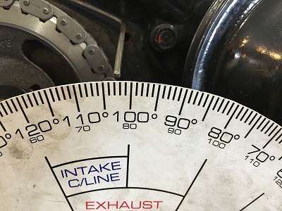

Cam gear.
I got the new cam in and degreed. This is the first cam in a long time that I did not have to move. The intake center line was marked at 106 degrees. Just lining up the dots got me at 103, 3 degrees advanced. So I buttoned it down right there.

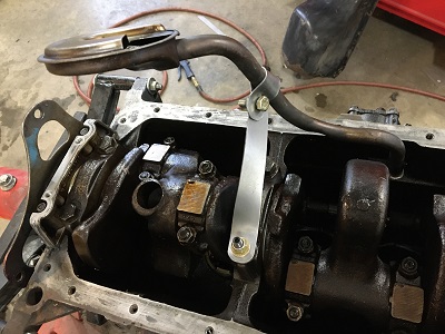

I also removed one of the main bolts and installed one bolt out of my windage tray kits in its place. Then I made a 1" wide strap / brace to my pick up tube. Now it is ready for the pan and final install.
